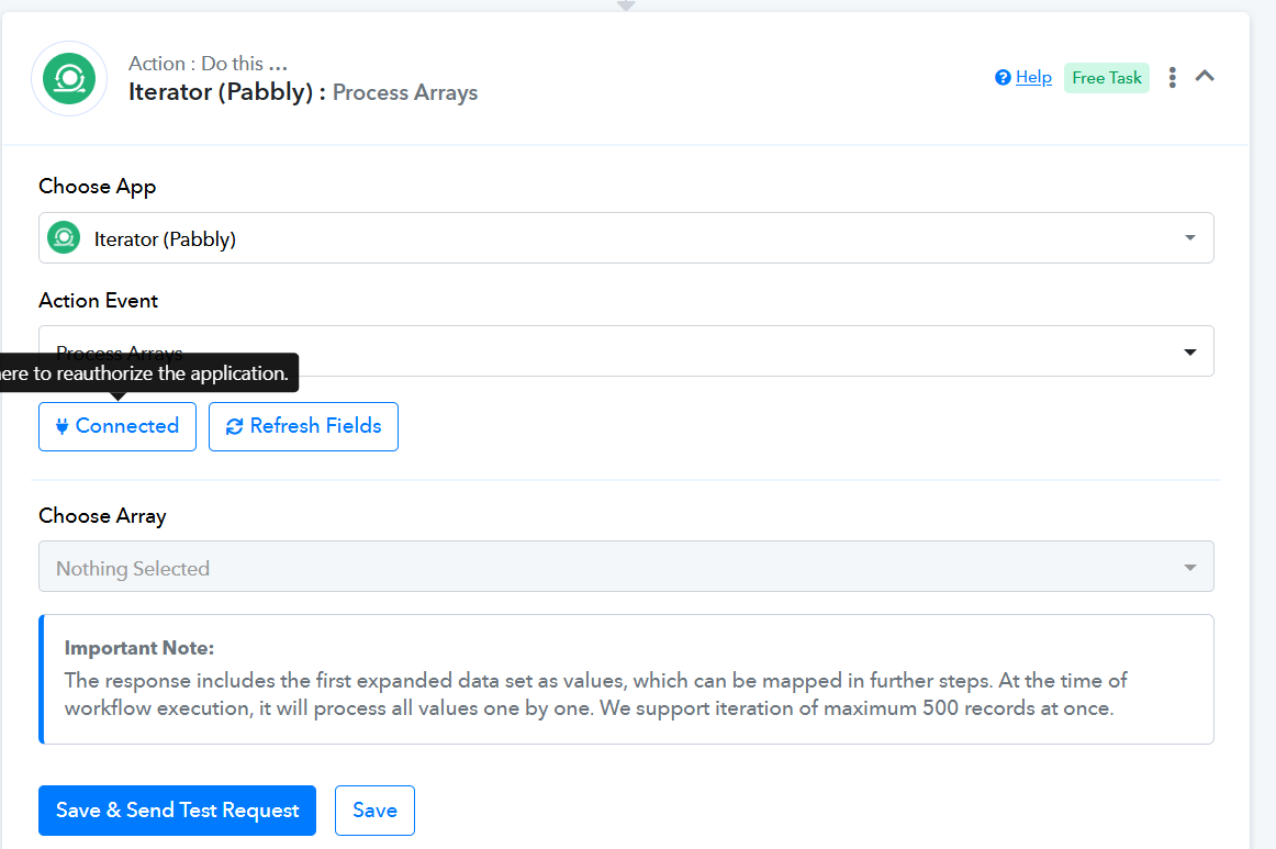

I am setting up a workflow with Chat GPT help. The workflow is to check global events in a Google Sheet created and then at key stages send out email promotions. I have started with scheduler, and then connected the Google sheet, it said to add iterator step and I have done that but am not able to select anything in choose array nor enter text. I have tried everything and am at a loss and AI can´t help me sort the issue.

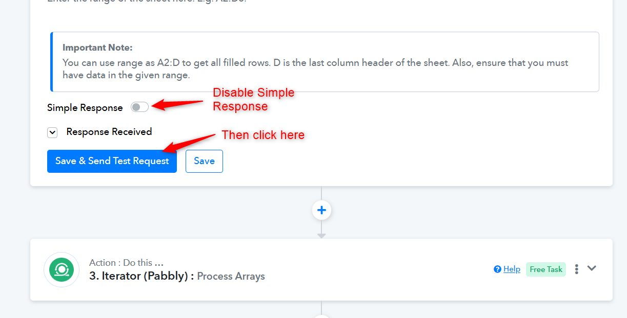

Hi @Stephen Crouch,
Please disable 'Simple Response' and click on 'Save & Send Test Request'. This should give you a response in the form of JSON, which you can use in the Iterator step.
Stephen Crouch — Reply ·
Yes that has worked - The labelling is incorrect. with a label of Simple Response showing grey Inactive should mean that it is active. When clicked it should be enabled.
Thank you for the update. A greyed-out 'Simple Response' button means it is disabled, while a blue button means it is enabled.
