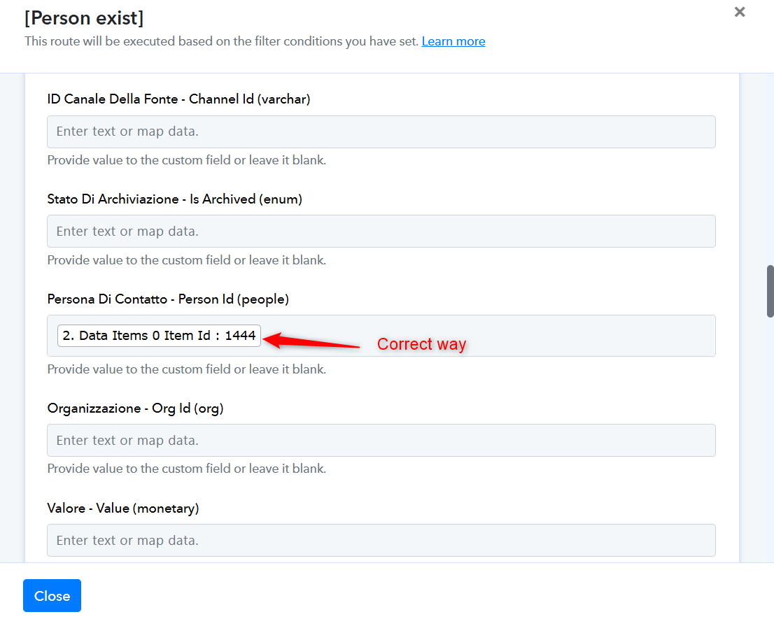

Specifically, we've created an automation with Router and we're having a problem with the PERSON EXISTS path.
When we create the DEAL, the step gives an error: Deal title must be given.
But the title is set.

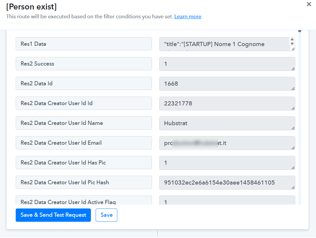

We can see that this action was working fine earlier, but the issue appears to have started today. To investigate this further, could you please allow us to execute the same action using the new UI?
Alternatively, you may also test the action from your end in the new UI and share the execution details with us. This will help us analyze the behavior more accurately and assist you accordingly.

It appears that the data was captured in the Pipedrive: Find Person action step in advanced format, which is why you were unable to correctly pass the ID to the Pipedrive: Create Deal with Custom Fields action step. We captured a simple response instead and then passed the Person ID to the Pipedrive: Create Deal with Custom Fields action step, which seems to have resolved the issue.
