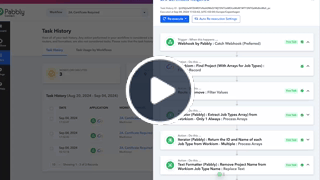

What happens here in the task history - why doesn't it run step 9-16 to the left? It stops out of the blue...?

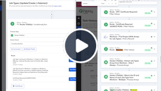

And same issue here:
https://share.zight.com/WnuWEGA9
It doesn't run any of the router items to the left despite it returning as true?
Instead it goes out a level and runs from step 3 to the left:
https://share.zight.com/04ungPgR
I see no logic in this.
Here's a video walking through part of this
https://share.zight.com/L1uEk7gN

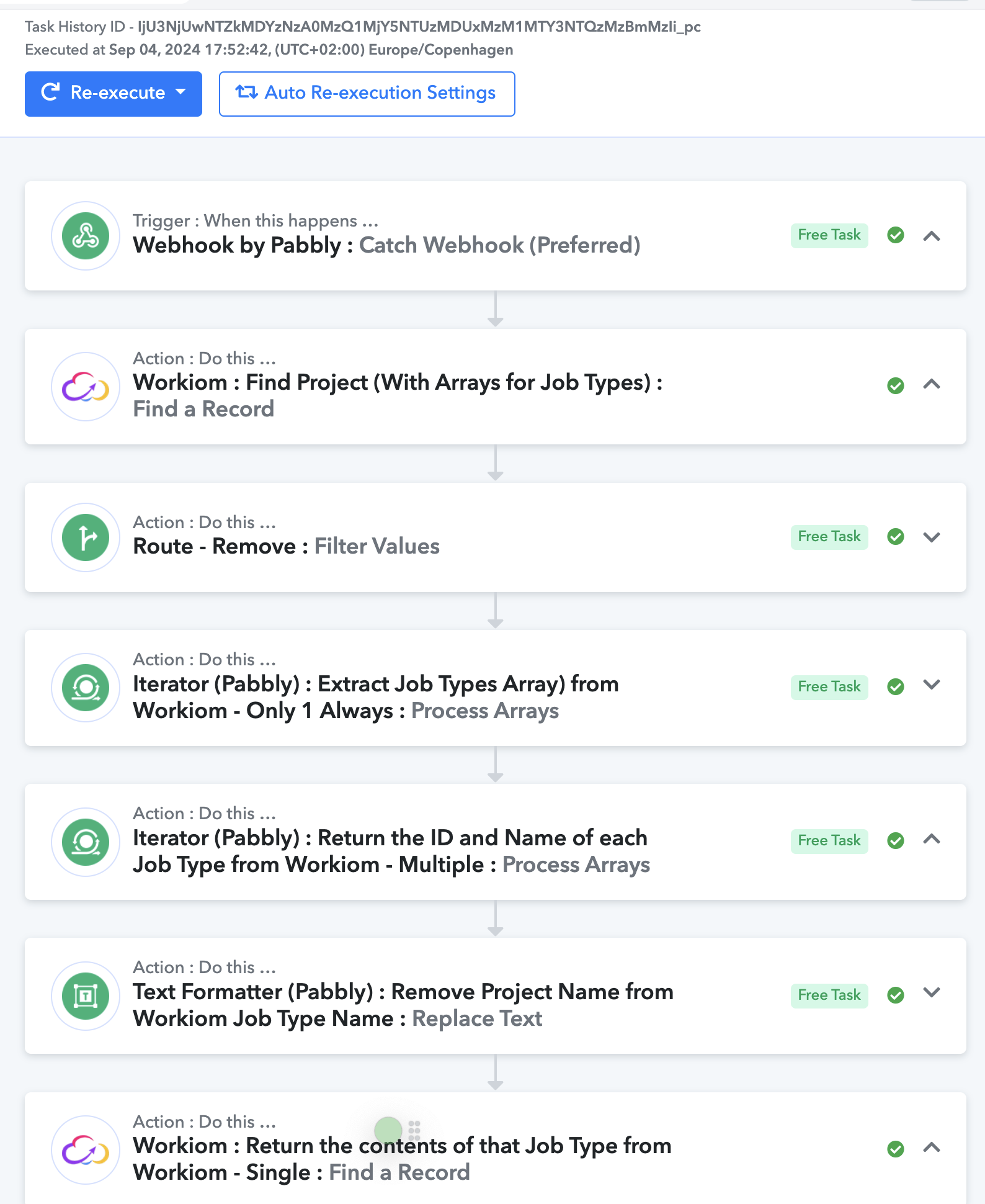

I made a new flow. It still doesn't work and the same happens. It stops in the middle of the execution. I don't see how this is supposed to happen.
I have multiple iterators because I need it (even and some only output 1 item), and it's a short flow and Pabbly stopping and messing up after just 7 steps as you see here is not useful:
This is a tiny flow so it can't be a data limit but seems to be a bug with the iterators.
See this video please:
https://share.zight.com/xQuJ0BYj
Could you report the issue on Pabbly's end and help me fix this simple flow?
Flow: https://connect.pabbly.com/workflow/mapping/IjU3NjYwNTZkMDYzNzA0MzY1MjZiNTUzYzUxMzMi_pc
History: IjU3NjUwNTZkMDYzNzA0MzQ1MjY5NTUzMDUxMzM1MTY3NTQzMzBmMzIi_pc
