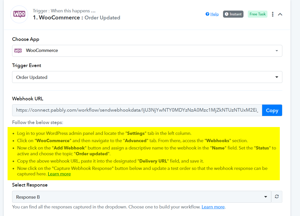

Hi @mdabusufian,
We are assuming the issue is related to WooCommerce not triggering the workflow, as there are only two workflows currently active in your Pabbly Connect account and both have WooCommerce as the trigger step. It appears that WooCommerce has stopped sending data to the webhook connected to both of your workflows.
We suggest that you clone both of your workflows and establish a new connection with your WooCommerce account in both of the cloned workflows.
