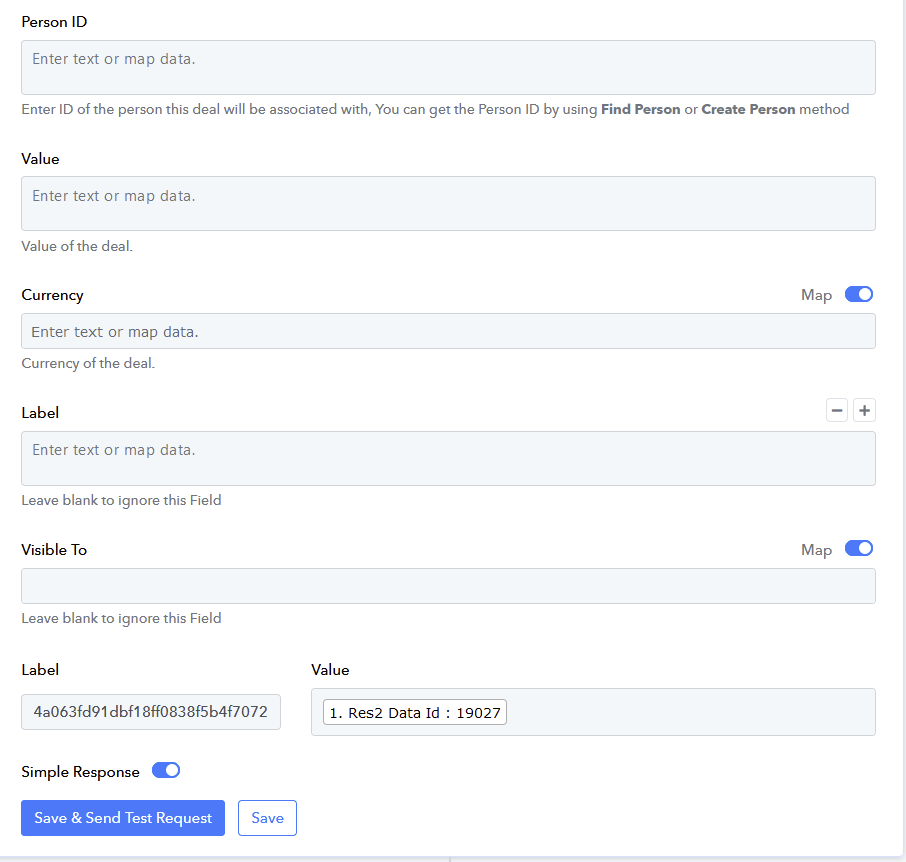

  2. When i foung the record, i could not identify the custom field by any name, it was labeled with an strange custom string label like this:
    Res2 Data 99 9460f7c7a8b4a063fd91dbf18ff0838f5b4f7072 (very hard to guess, or do i miss here any used syntax maybe?)

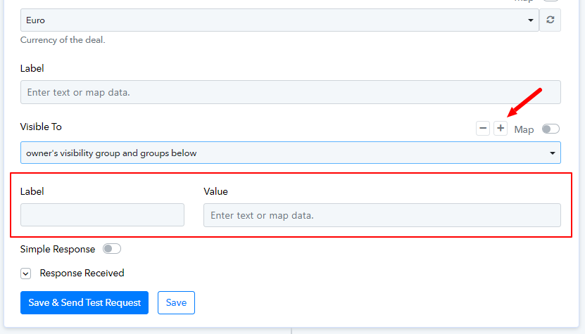

If you'd like to add more fields to be updated under the "update deal" action, you can click the (+) button to add pairs of labels and values. Please refer to the attached screenshot for guidance.

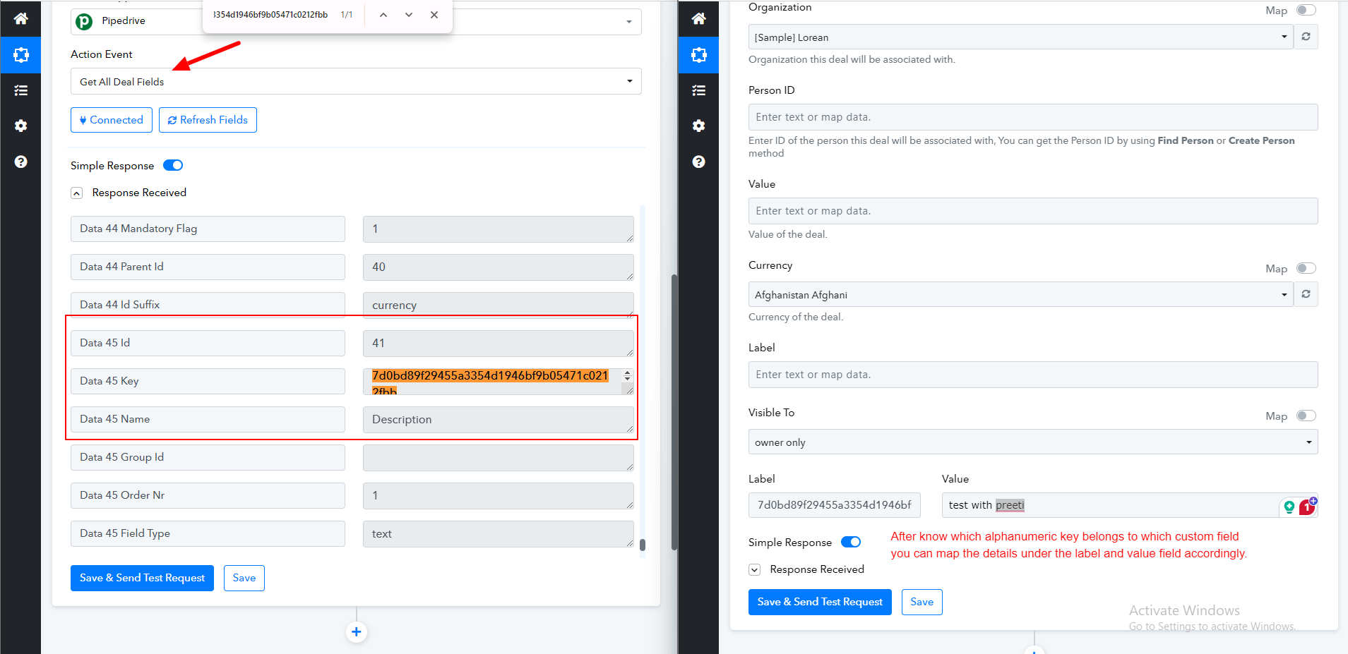

To update a custom field, you can find the custom field key using the "Get All Deal Fields" action. This requires a one-time manual setup, which is detailed in the screenshot provided below.
i have such a hard time to discover the right one
You can obtain the custom field key from the New Deal trigger response. Look for it in the response from the "Get All Deal Fields" action. Once you identify the associated label, you can map the custom field key and its value accordingly in the "update deal" action step.

I tested like you said, i checked for the field that contained the value and this aplhanumeric part i copied into a new label field and for the value took the record id from the first step where it checks for the new Deal.
I tested with a new creation but it did not work.

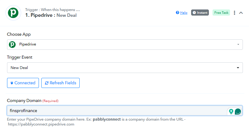

Hello @Finspro

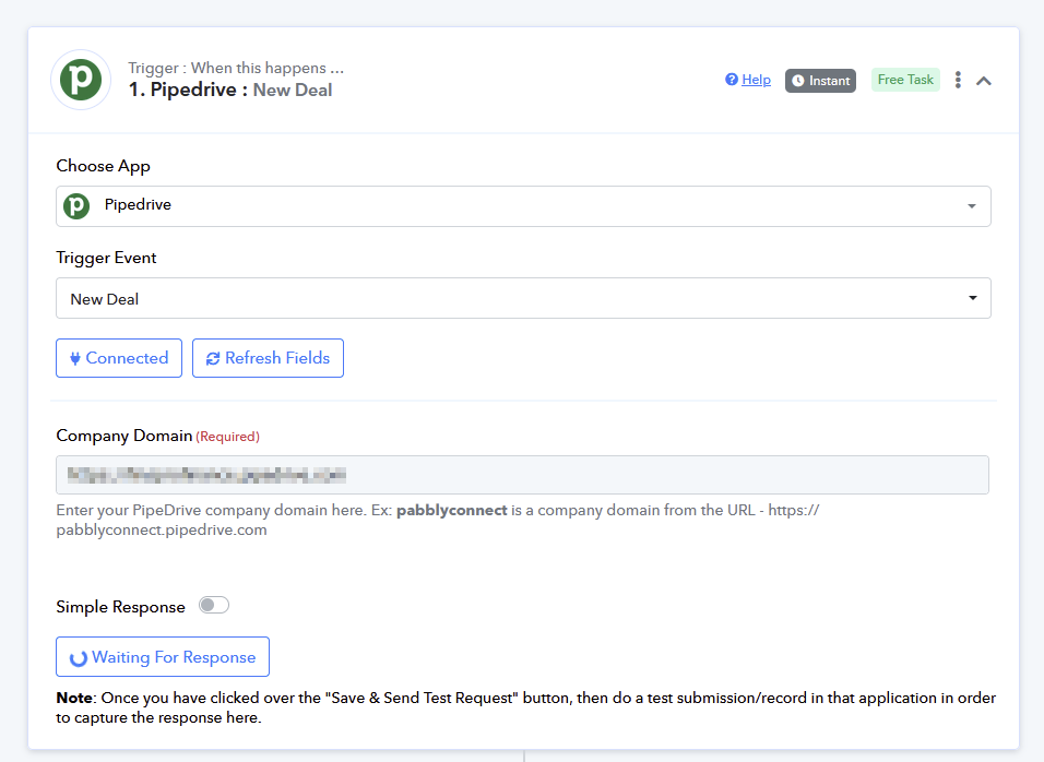

Kindly set up a new workflow and add the Company Domain as mentioned in the image below. You can also refer to this tutorial -
youtube.com/watch v=2bnGCXEIkCw
Let us know if you face any further issues.
Finspro — Reply ·
Hi @Preeti Paryani,
good morning :)
Good news first:
i changed the Company Domain according to your recommendation from full URL to just the Company Name part.
Although i received also data from Pipedrice before as well, i have the impression, that now after the change the listening function is working correctly so i can use a single entry to check for, thank you for this hint.

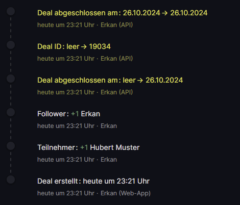

Hi @Preeti Paryani ,

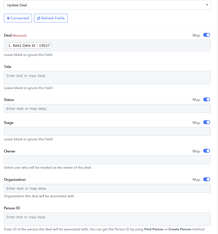

i did a fresh test, for that a new deal has been created and even all steps from the existing workflow i deleted and setup new to have fresh setup.
For the update step, i left every field blank, except the ID for the Deal to be updated (it was mentioned as required) and the desired update for the custom field (Deal ID) which i also updated with the record ID.

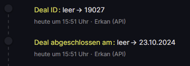

Here are the screenshots so you can see i have no more updates:
BUT, as before, the Close Date and Close Time (reflected in the screenshot below as "Deal abgeschlossen am:") seem to get updated from blank to current date (maybe also time but here it shows the date), but i do not want that.
Please double check that as well.
It is crucial that nothing that is not mapped or selected to get updated gets not touched.
Also, would it be possible to get the fields for the update action not prepopulated with any data (in this case it was not even the data of the record i used in the trigger listening record, but just record number 1 from the database in pipedrive)?
just tested again for the workflow.
And i got this (all yellow stuff came through Pabbly)
So it means, now it even tries to set the Close Date (or time or both) 2 times, instead of once previously. :(
First it sets from empty to the current date, and then again like setting a second time.
So whatever you did, it made it worse.
Please check this again, this can not be used like this.
