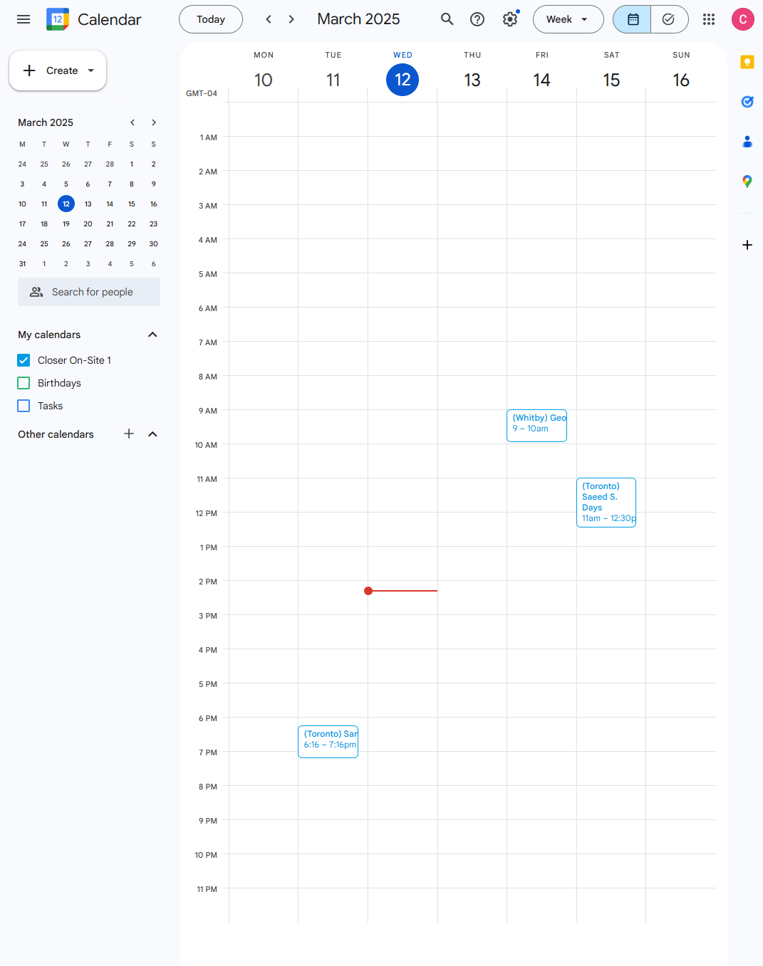

I have a workflow that allows me to create and edit Google Calendar events using a custom Event ID. These actions work as expected; however, I encounter an issue when attempting to delete those same events using the "Google Calendar: Search and Delete Event" function.

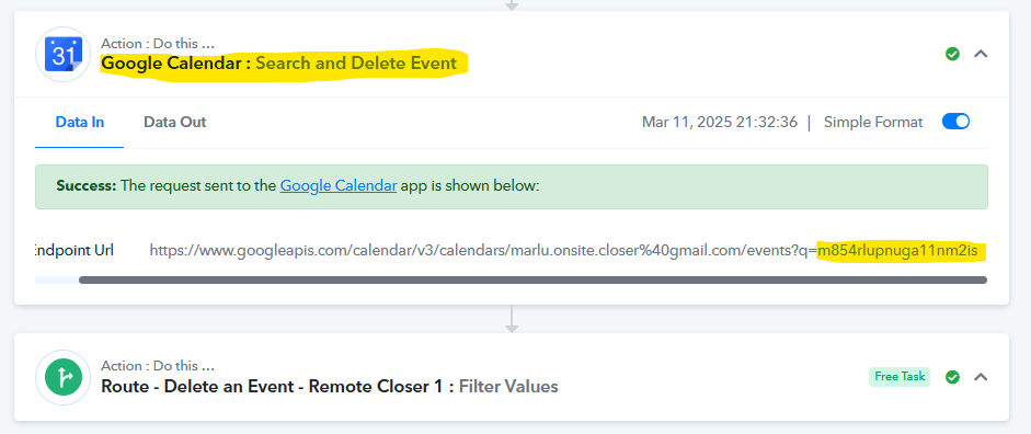

I specify the same Event ID as the "q" parameter (as shown in Picture 1 & Picture 2). The process runs and returns a "Successful" status, yet the event does not actually get deleted from the corresponding calendar.
Note: I have already verified that the request is targeting the correct user's calendar.
Picture 1:
Picture 2:

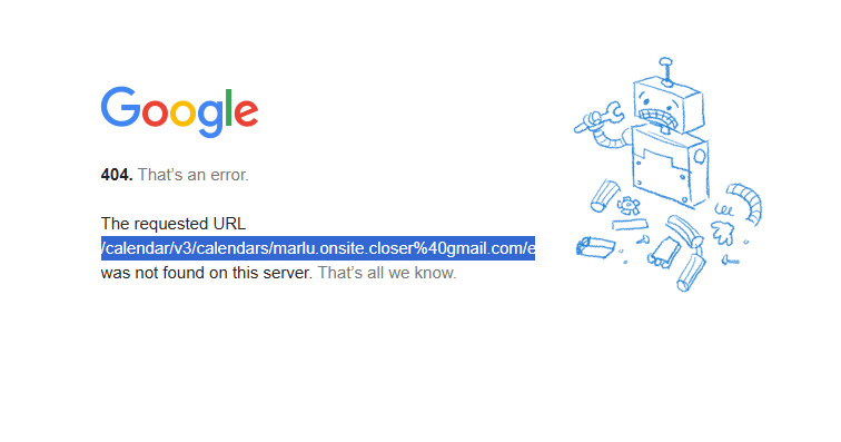

[IMG width="624px" height="188px"]https://lh7-rt.googleusercontent.com/docsz/AD_4nXe5qNCfwFhfC9OqYd_e2ziuiE4wcMpREEt0WV-iXaWixWHuCDQnjV1JNy8wGrlugTVEz93JnCh6KObcsx8NeNK1qLqTTT3sqpJsULurK30NTzhzNn5tOSqYAiwB0VqKWhw94QMP?key=PL4GUVQWZ8u13PditD4i_cYb[/IMG]

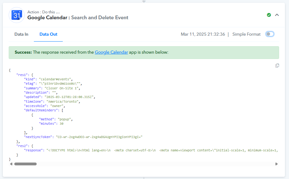

Hello @R.Barona,
The response you are receiving indicates that the event was not found. Please refer to the attached image for more details.

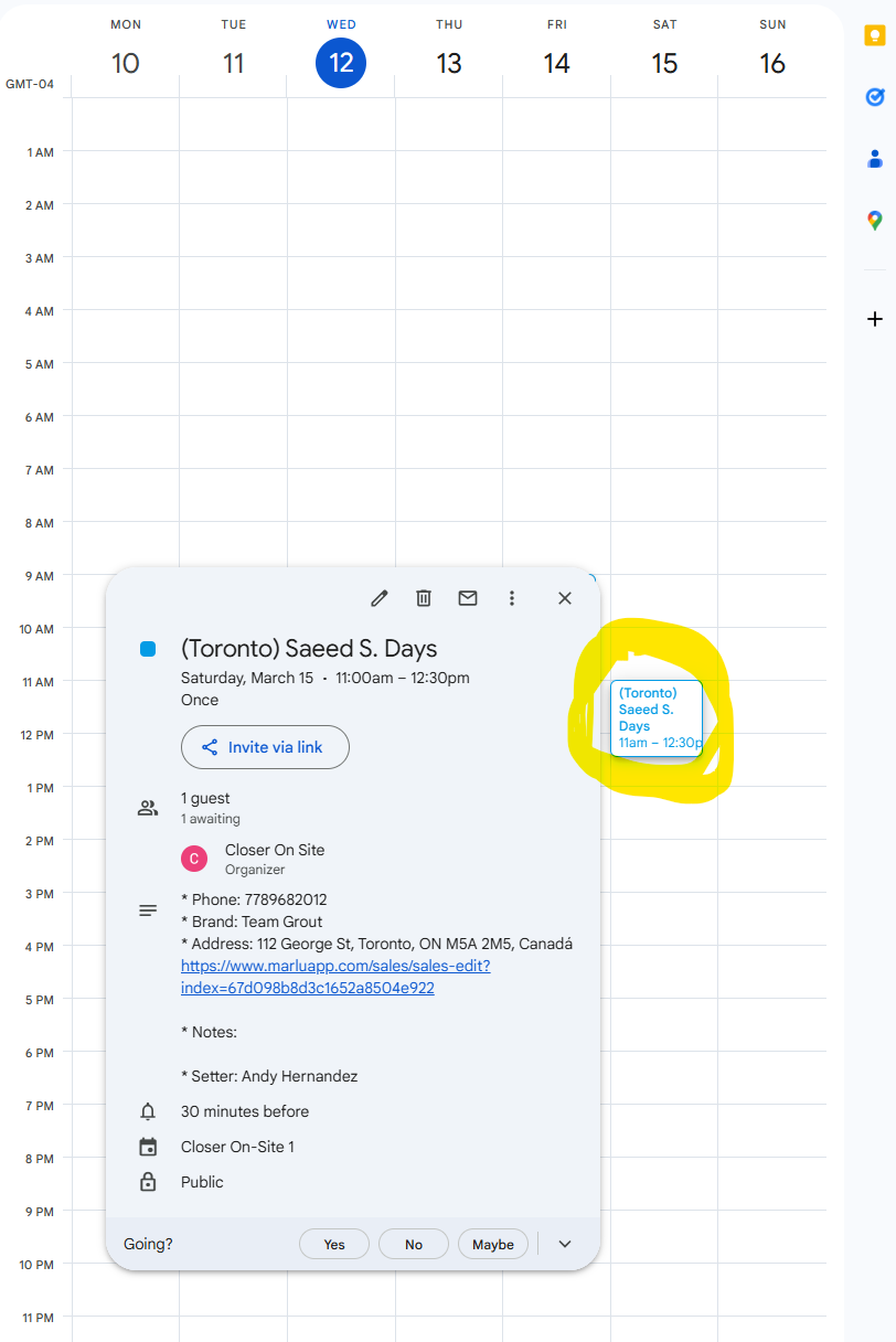

To provide a better demonstration, I have now created a new test case (Picture 1), where I:
1️⃣ Create a new event.
2️⃣ Edit the same event.
3️⃣ Attempt to delete the event.
After running these steps, I can confirm that the event still remains on the calendar (Picture 2), proving that the deletion did not take effect.
Picture 1:
Picture 2:

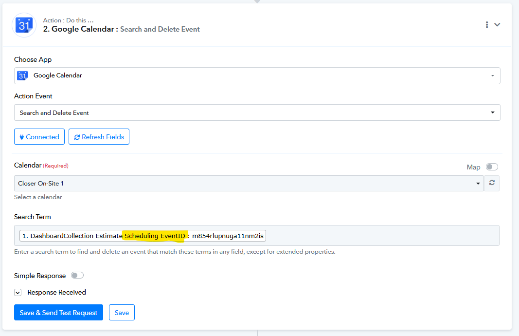

Yes, I think it worked because I don't see the 'PC Test' event:
In the 'Search and Delete Event' action step, you need to search for the event using its name instead of its ID. This should resolve the issue you are encountering.

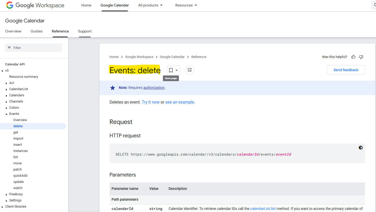

Would it be possible for you to add the official Google Calendar API delete event operation to Pabbly, as shown in their documentation?
https://developers.google.com/calendar/api/v3/reference/events/delete

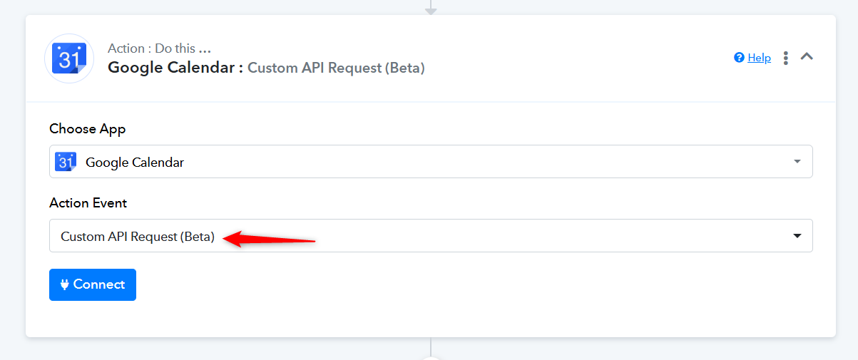

In the meantime, you can try executing this endpoint using the 'Custom API Request' action event.

Hello @philgsm,
As of now, we have not introduced a native Delete Event action.
However, you can explore the Custom API Request feature to achieve this functionality by directly interacting with the calendar provider's API.
