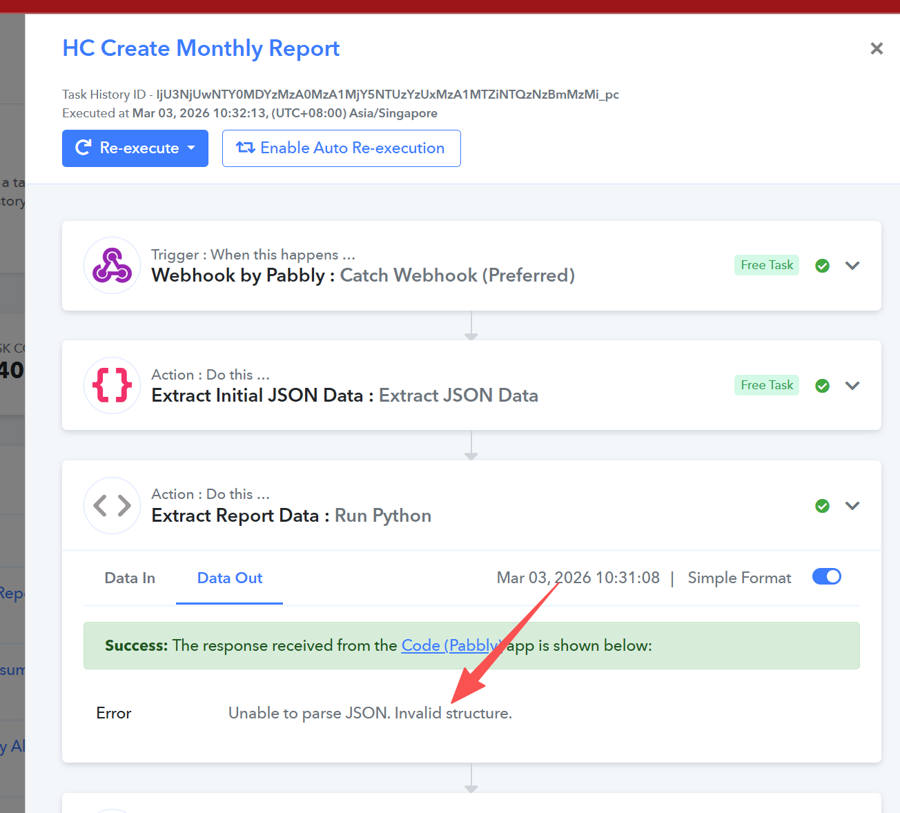

Your kind support has actually assist to create the python code back then that assist to extract figures from webhook (JSON)

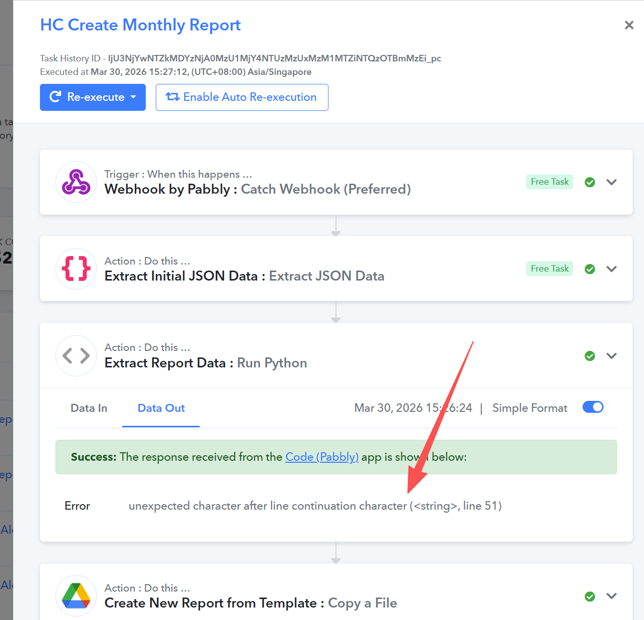

Today we have met this error out of sudden.
Workflow: HC Create Monthly Report
Task ID: IjU3NjUwNTY0MDYzMzA0MzA1MjY5NTUzYzUxMzA1MTZiNTQzNzBmMzMi_pc
The resultant file output: https://docs.google.com/spreadsheets/d/1Bx1Q-ng1TDTvzUuZnEtkSfeQLltI6Yvf_VwhbxmQGD4/edit?usp=sharing (There is no rows of data which ought to be retrieved by Step 3: Extract Report Data.
Error: See attached.
WE don't have this error before. Kindly advise as soon?

We tried again. Failed. Please see
Task ID: IjU3NjUwNTY0MDYzMzA0MzI1MjY5NTUzMDUxMzc1MTZiNTQzOTBmMzMi_pc

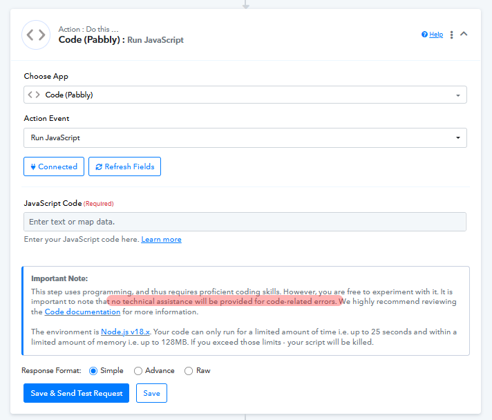

Please note that, typically, we do not provide technical assistance for the Code (Python/JavaScript) steps, as these require custom scripting and fall outside our standard support scope. In some instances, we have assisted you earlier; however, it may not be feasible for us to provide ongoing support for code-related issues across all workflows.
That said, you may consider using AI models or developer assistance to generate or refine the code based on your required input and expected output.

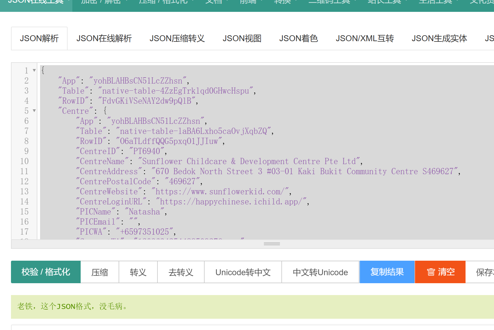

We have checked with Grok and the following mention about the issue with the Python script when chinese characters are met.
https://x.com/i/grok/share/fdd11862f95346f39c6ddd8c1f6942c9
Is not that we didn't try consulting AI LLM, but the inherent issue may also be the Python Pabbly treating Chinese Characters.
The attached is exactly the JSON sent from Glideapp. We have checked there's nothing wrong with the JSON.

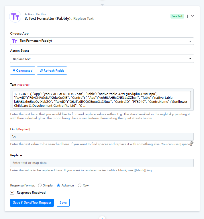

Hi @ichilddev,
Thank you for your patience.
We have made a few updates to your workflow. Please note that the previously added Code (Python) step has not been changed.
What we have done:
- Added a Text Formatter step before both Code steps
- This step replaces the \n (backslash N) from the incoming JSON data
- The output from this step is then mapped into the Code step (currently Step 5)
- The Python code in Step 5 is used to extract the required information, and it appears to be working correctly, even when the data contains Chinese characters

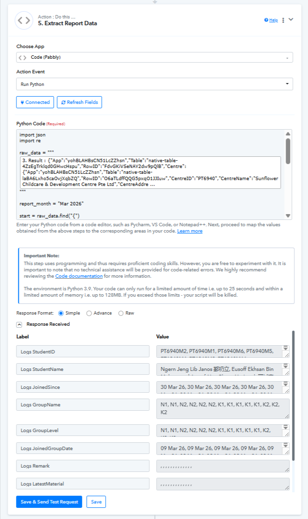

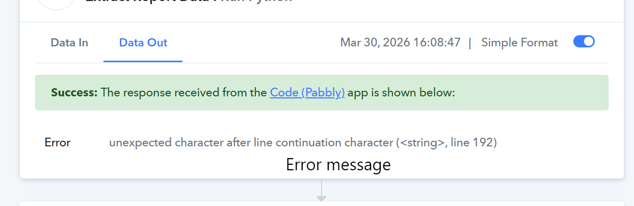

Dear Support
I have follow your instructions to use the Formatter Text from Step 3 and include inside Step 5 Python Code.
However, when i did the replacement, the code breaks again.
What is the issue here? What did you do to include the values from Step 3 nicely into the Python code?

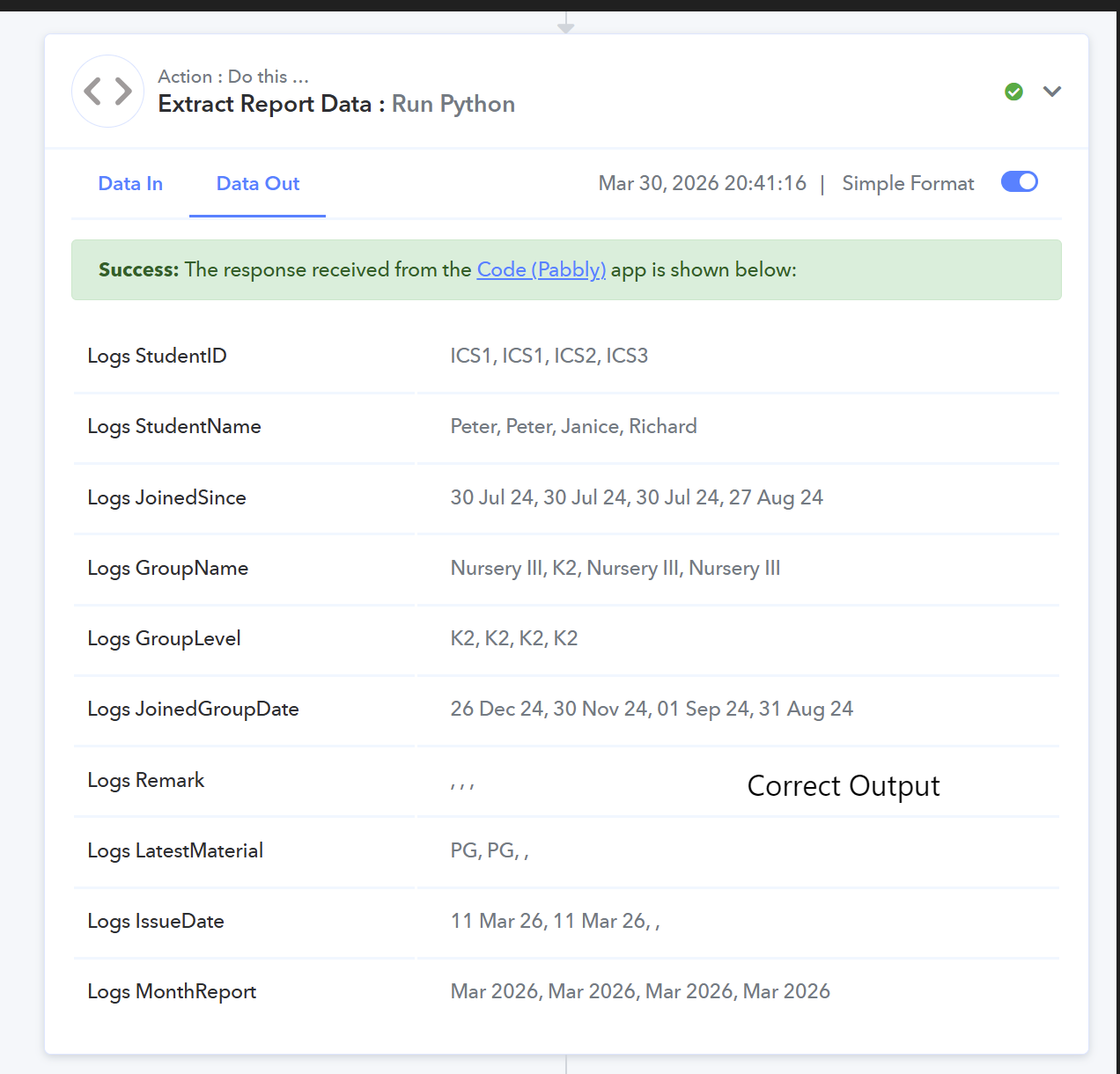

Hey @ichilddev,
The code I shared earlier was properly indented, but due to formatting limitations, the indentation was not preserved, which caused issues when you edited the Python step.
We have now corrected this on your workflow.
I have also attached a Google Doc containing the exact code with proper indentation for your reference.
https://docs.google.com/document/d/1J1GqF1LmzrdVyosYSiLAHH_BGL3SV37IxTApy6IFP4I/edit?usp=sharing
Please make sure that:
- The JSON input is mapped from Step 3 (Text Formatter)
- The month field is also correctly mapped in the action
This setup should now work as expected.
