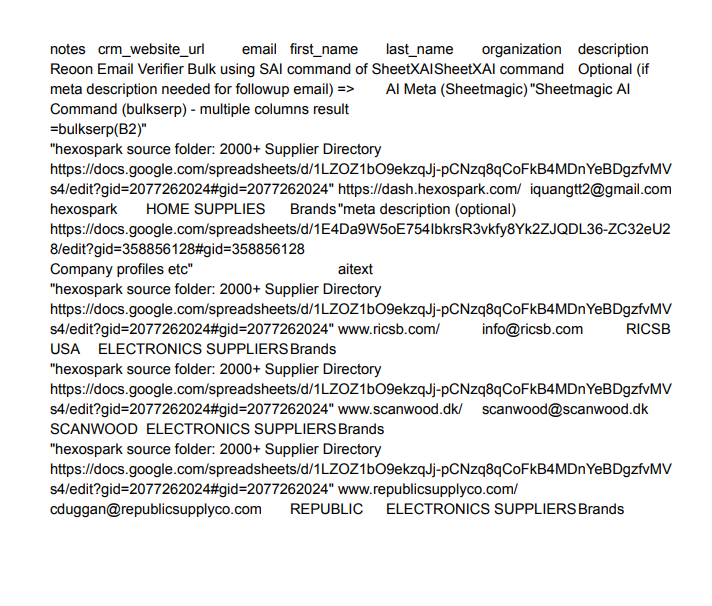

Issue: I don't know how to add multiple email addresses to the email address field: https://d.pr/i/Cqk2Y2
The list can have thousands of emails, so it is impossible to add them one by one.

Upon checking, we found that the "Submit Email Addresses (For Bulk Verification)" action requires comma-separated email addresses, not a file URL. In your case, the uploaded file contains data in a different format, as seen in the screenshot.
