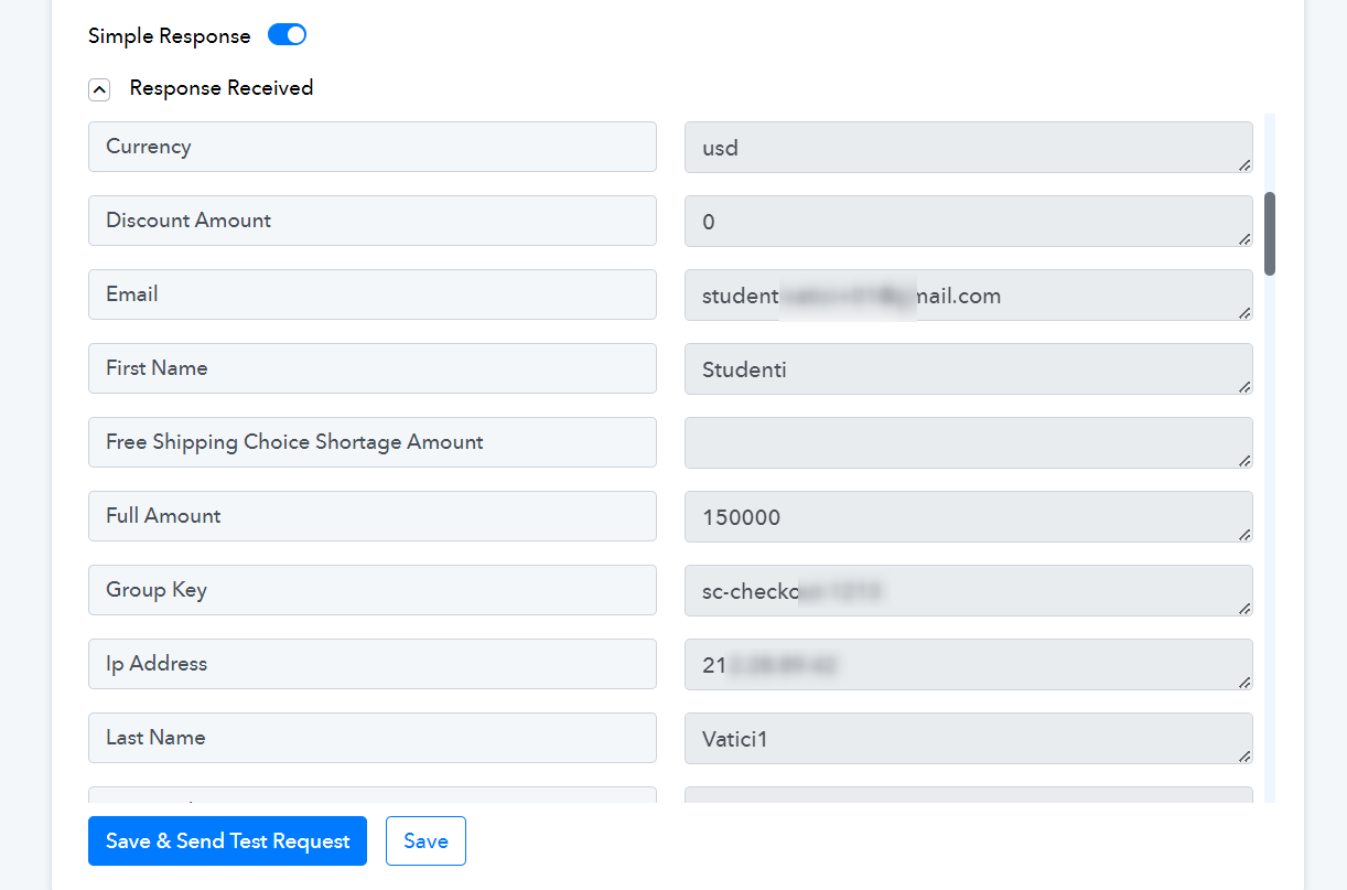

I have connected SureCart with Pabbly Connect and I'm trying to map the data to Google Sheets, specifically fields like First Name, Last Name, Email, Address, City, and more. However, I'm unable to map the correct data because these specific fields are not showing up properly; instead, I only see random numbers.

It seems that you have used the 'Get Checkout by ID' action event as step 2 of your workflow, which appears to be giving you the correct result.
raiaceban — Reply ·
No, the shipping address is still missing when I use the "Get Checkout by ID" method.

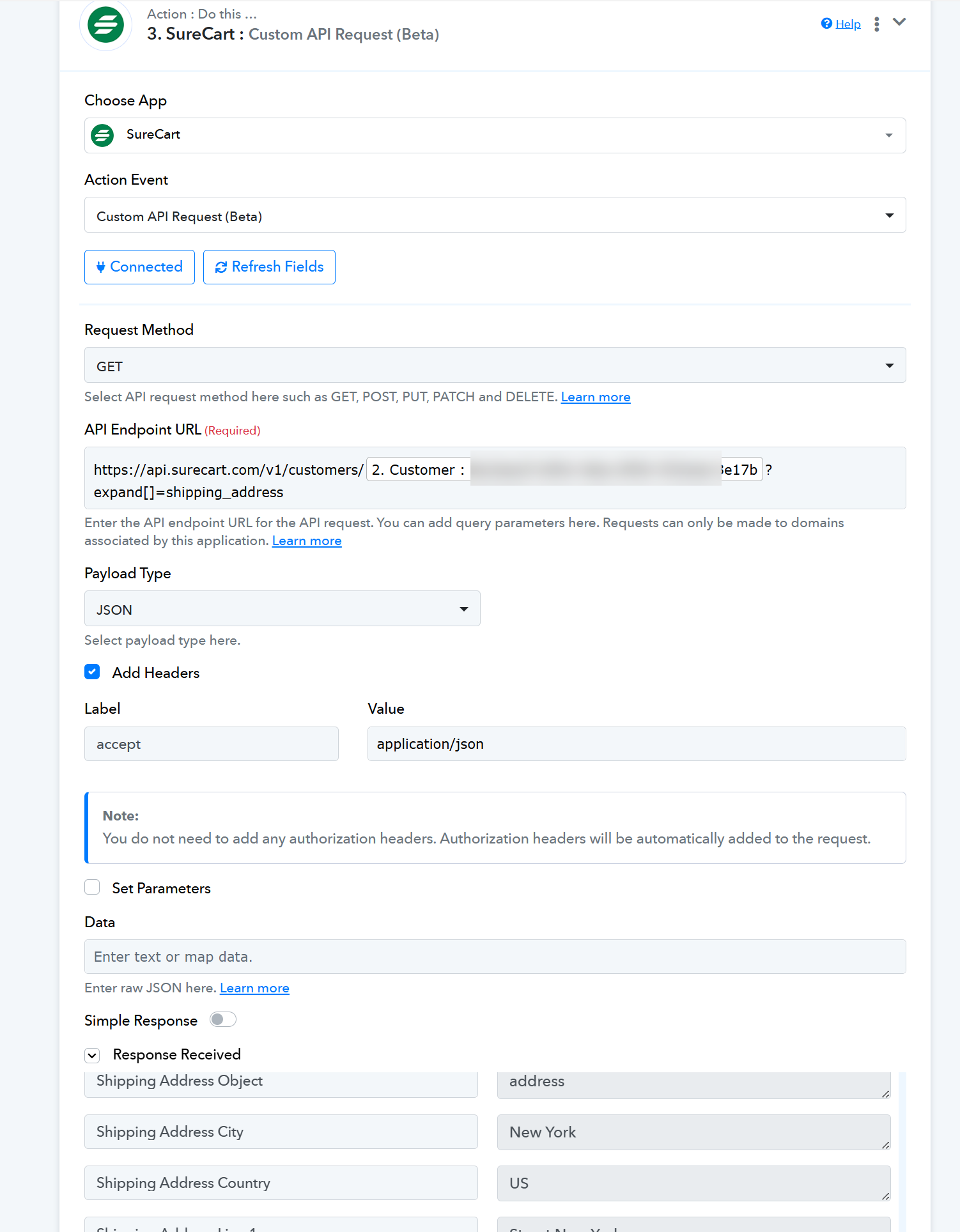

However, I tried using the Custom API Request for the Event, and after consulting the SureCart documentation, I found the correct API endpoint. It worked only then.
It would be ideal in Pabbly Connect to have all the data retrieved in just 1-2 steps (which is currently possible in SureTriggers).
