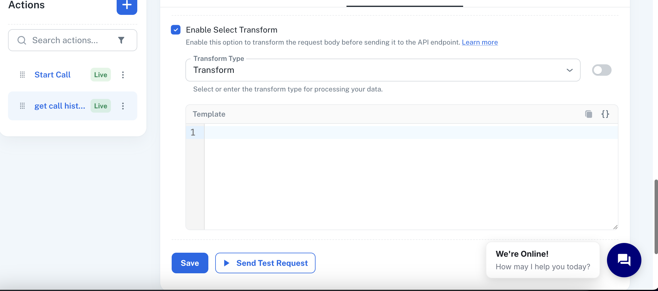

I am configuring a multi-step action in Pabbly Connect that starts a call and then checks the call status through a GET API request.
I need the workflow to repeatedly call the status API until a specific condition is met.

I have attached screenshots of my current action and API configuration for reference.

If you are using a Custom API Request, we assume you have already configured your workflow. Could you kindly share the workflow URL with us so that we can review it and provide more specific guidance?
Based on your requirement, you can try the following approach:
  1. Execute the Custom API Request to fetch the call history/status.
  2. Add a Delay step after the API request.
  3. Call the same Custom API Request again.
  4. Add a Filter to check whether the status is queued or in-progress.
  5. If the condition is true, add another Delay followed by the same API request again.
  6. You can repeat this sequence as many times as required, depending on the average time it takes for your calls to complete. Set the delay duration accordingly.
Once the API returns a status other than queued or in-progress, the filter condition will no longer be satisfied, and the subsequent polling steps will not execute.
Please note that this approach requires adding the polling steps manually based on the expected call completion time, as Pabbly Connect does not currently provide a native "loop until condition is met" or self-repeating polling mechanism within a single workflow execution.
If you have already created the workflow, please share the workflow URL with us along with your confirmation:
"I confirm Pabbly to access and test my workflow for troubleshooting purposes."
We will then review your workflow and guide you further.
