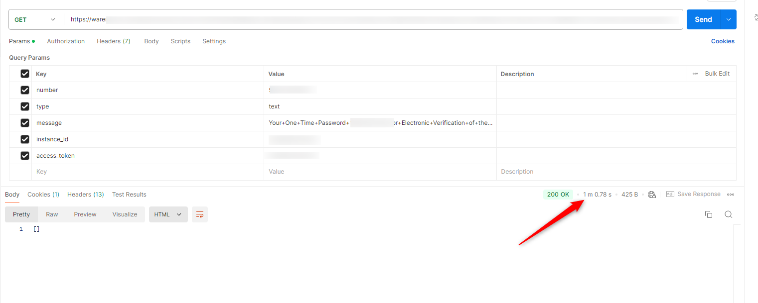

We have reviewed your API endpoint and found that it exceeds the 25-second time limit, which is likely causing the issues you're experiencing. Please refer to the attached screenshot for more detailed information.
