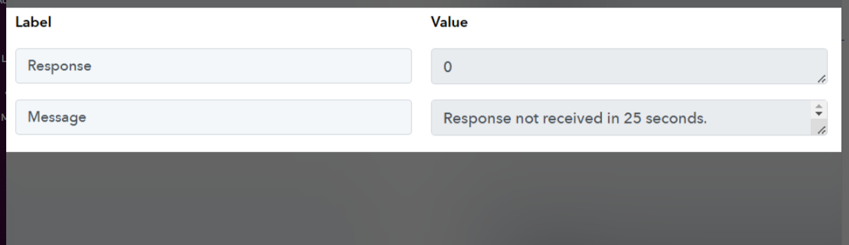

Hello! Can anyone help me with this? It's happening to all of our workflows

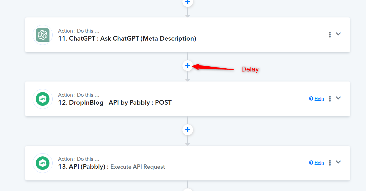

Try adding a Delay after Step 11 of your workflow and see if that fixes your issue.
can you please take a look at the full workflow and give any additional suggestions?
or what is the suggested delay time for this?

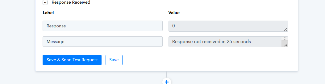

Pabbly Connect waits for 25 seconds to receive a response from any application. The issue you are describing occurs when an application takes more than 25 seconds to process a request, and because of this, Pabbly Connect does not receive the response within 25 seconds, leading to the error you encountered.
In your case, it seems the application you are trying to post to takes more than 25 seconds to process the request and return a response to Pabbly Connect. I’m afraid there is no workaround for this at the moment. The application you are trying to send the custom POST request to needs to return a response within 25 seconds.
