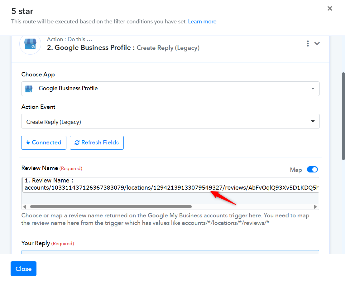

However, I’m still facing the same issue — the test action for "Create Reply (Legacy)" fails and does not send any response.

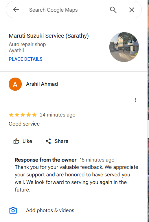

In the 'Review Name' field, you didn't map the value from above, which is why the new reviews weren't being replied to. We have done that on your behalf, and it appears to have resolved the issue.
Thankyou Very much dear @ArshilAhmad
