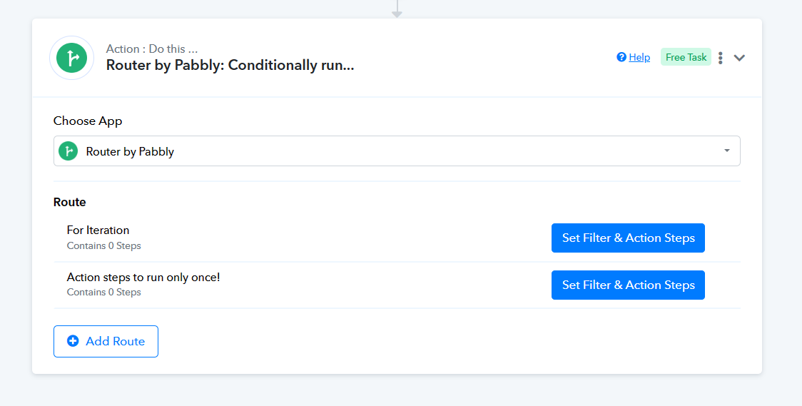

Hey @Dom T
However, this question is still unanswered: How do I run an action ONCE and AFTER the iterator is completed?
Regarding your particular concern, you can try creating 2 routes using the Router action step.
You can use the Iteration of the action step inside 1st route and in the 2nd route, you can use the action steps which you want to perform only once.
Thank you.
Hey @Dom TRegarding your particular concern, you can try creating 2 routes using the Router action step.
Sorry for involving myself in this thread but I have the same issue - and have 2 questions about @Supreme's solution. If you do this:
1. Will the Route "Action steps to run only once!" only run AFTER the "For Iteration" route?
2. Will the complete combined output of the route "For iteration be passed to the Route "Action steps to run only once!"?
I need to do the same however I need to use the full output of the route "For Iteration" in the "Action steps to run only once!" route - is this possible?
Yes, the "Run Only Once" After route will run after completing the Iteration from the 1st route.
Even if it passed after completing the Iteration I have set up the Counter step with the help of the Filter step which will only allow to process further only once.
Yes, the Only Run After route will run after completing the Iteration from the 1st route.
Where do you see the "Only Run After route" option? I don't see it
Correction, please check the route "Action steps to run only Once!".
@Supreme Sorry, I don't see that option anywhere. Which router and where in the flow?
