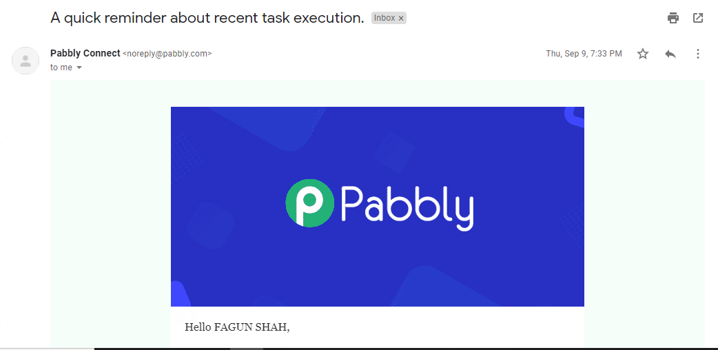

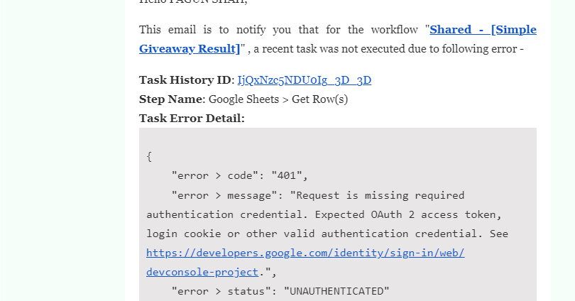

Fagun Shah — Reply ·
You do get one email for failed execution, check your spam folder once -

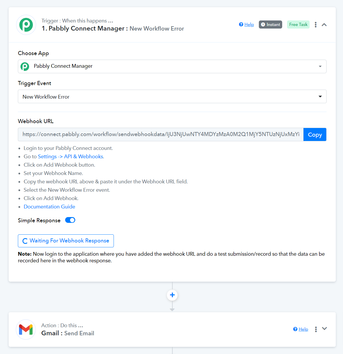

Is there a way to get notified to a specific Pabbly account user?
Also is there a way to get notified only after all Re-Executions have failed, and not just the 1st time it failed?
To send workflow error messages to a non-registered email address, you would have to set up a workflow. You can use Pabbly Connect Manager's "New Workflow Error" trigger event, which will trigger your workflow whenever an error occurs in a particular workflow. Then, use Gmail to send error notifications to an email address of your choice.
