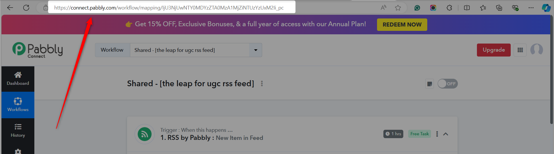

Can you please share the workflow URL once you have experienced this so that we can check the action step accordingly?

Hey @tjnewberry8
Regarding your concern with the dynamic web page, we will be required to check your workflow from where the URL is getting generated.

Workflow URL -
