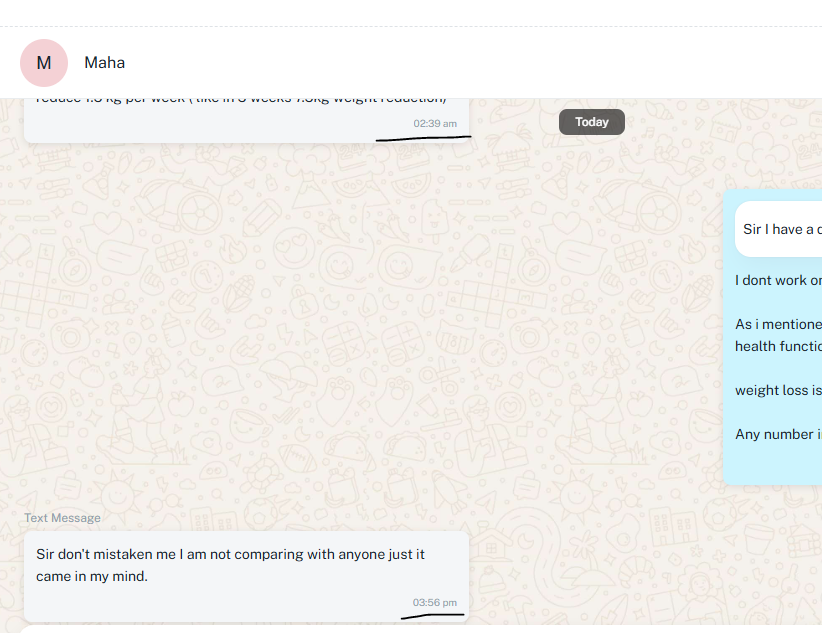

The message which is sent from this client at 2:39 has been captured via the webhook and being stored in my db. but the messgae came at 3:56 pm arent recorded as webhhok doesnt send it to my n8n

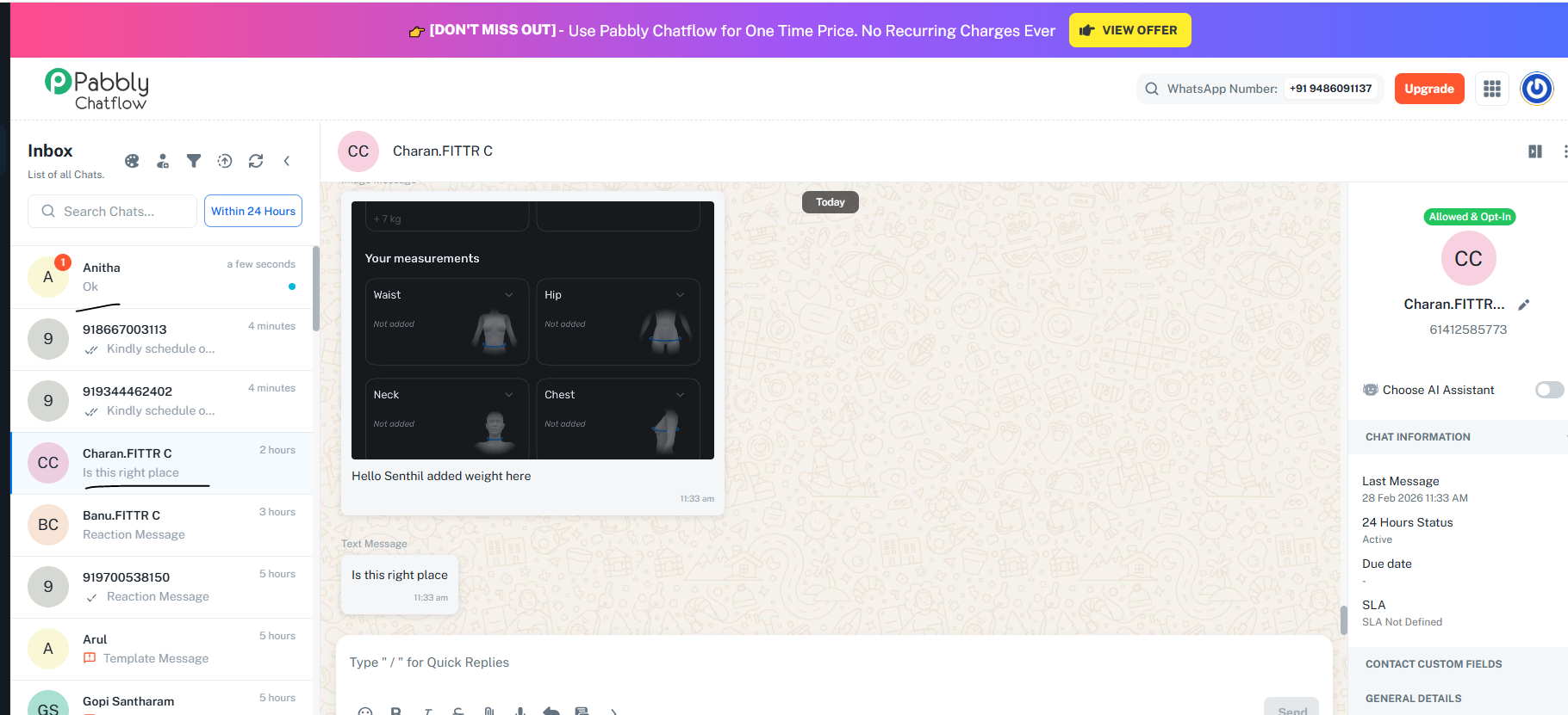

I expect a quick action over it. as my agents arent replying for the incoming messages and it makes manual load again. even now, the message from charan arent passing via api but message from anitha has been recorded
