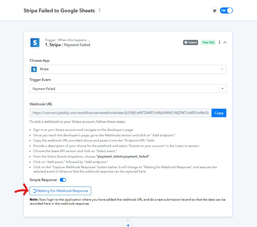

What am I doing wrong connecting Stripe failed payments to Pabbly? I'm stuck with step 1 which is capturing the webhook response. It's stuck in "waiting for webhook response" when I set it up according to the instructions.

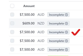

1. I see an "incomplete" payment in Stripe's Transaction tab.

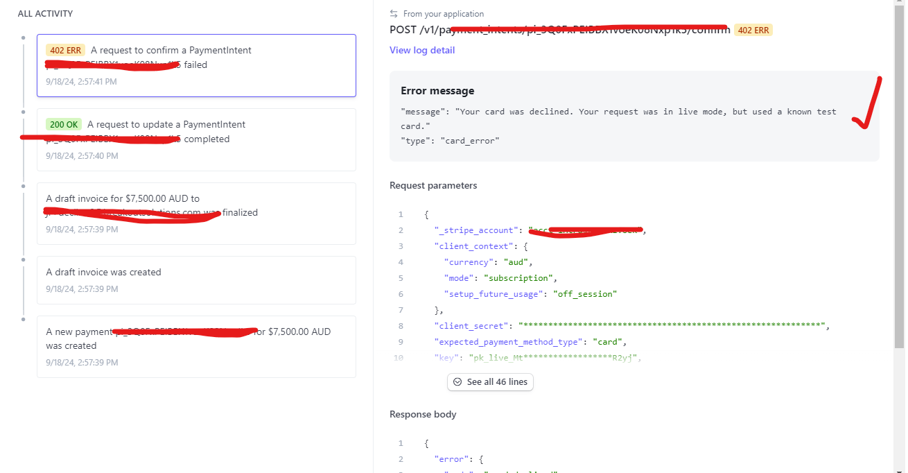

2. When I click the "incomplete" payment I can see that 402 ERR A request to confirm a PaymentIntent failed

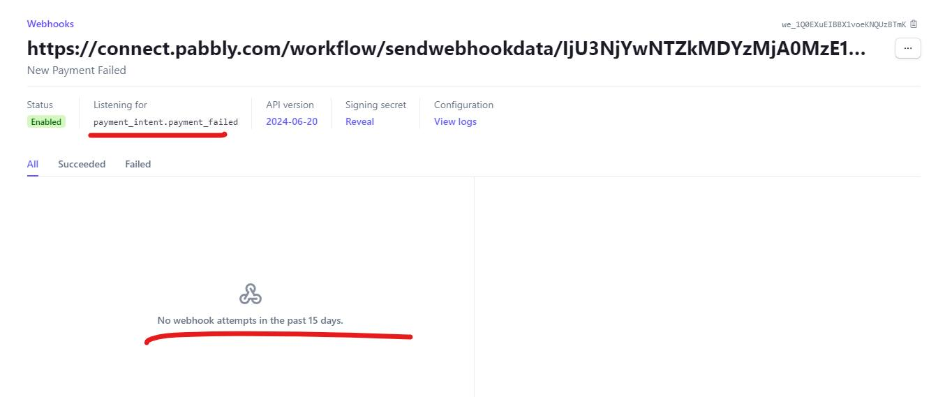

3. When I go to Developer's Webhook section there's no log of the failed transaction and it says - No webhook attempts in the past 15 days.
4. Stripe webhook trigger in Pabbly just keeps waiting on the response.

Hello @JRF
Please try to set up the trigger step following this tutorial -
youtube.com/watch v=tk3Ad6lJSoI
If you still face the same issue please let us know.
JRF — Reply ·
Thank you @Preeti Paryani! It works. The main issue the first time I tried it was that I didn't create the webhook in TEST MODE inside Stripe. Perhaps the team can also add that in the instructions after choosing Stripe: Payment Failed trigger inside Pabbly Connect.
