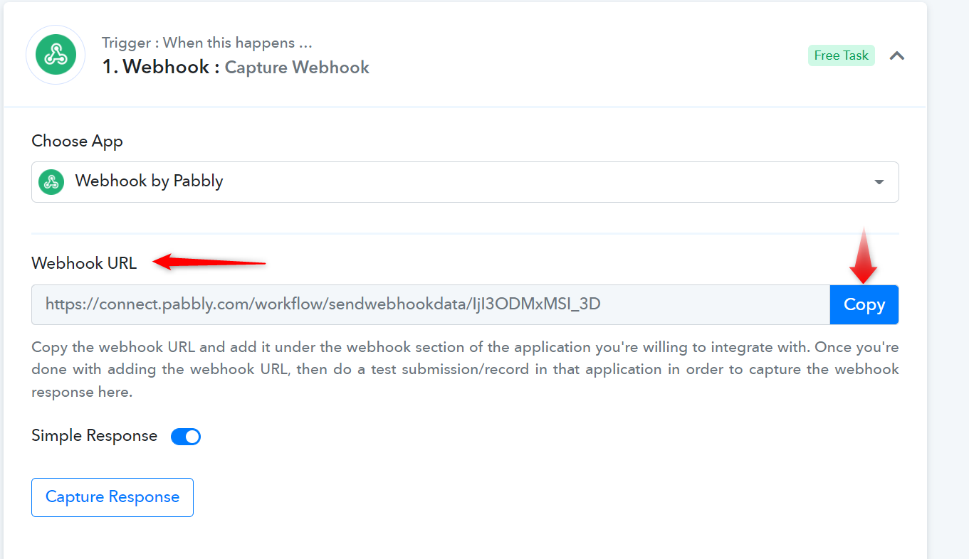

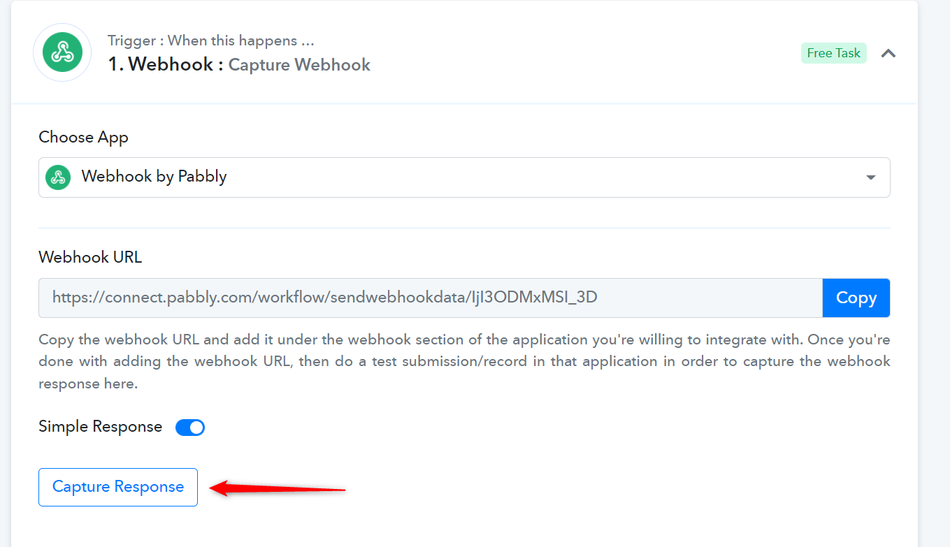

For checking into Pabbly Connect you have to create a Workflow on the Dashboard after that will get the URL which you can copy and paste into your Webhook URL field in PSB. So once an event will triggered then you will get the notification in Pabbly Connect after clicking on Capture or Re- Capture Response under the created workflow.

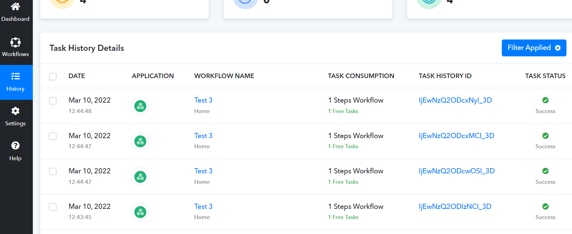

Also under the History tab you will get all the notification for the events triggered whether it will be successful or failed.

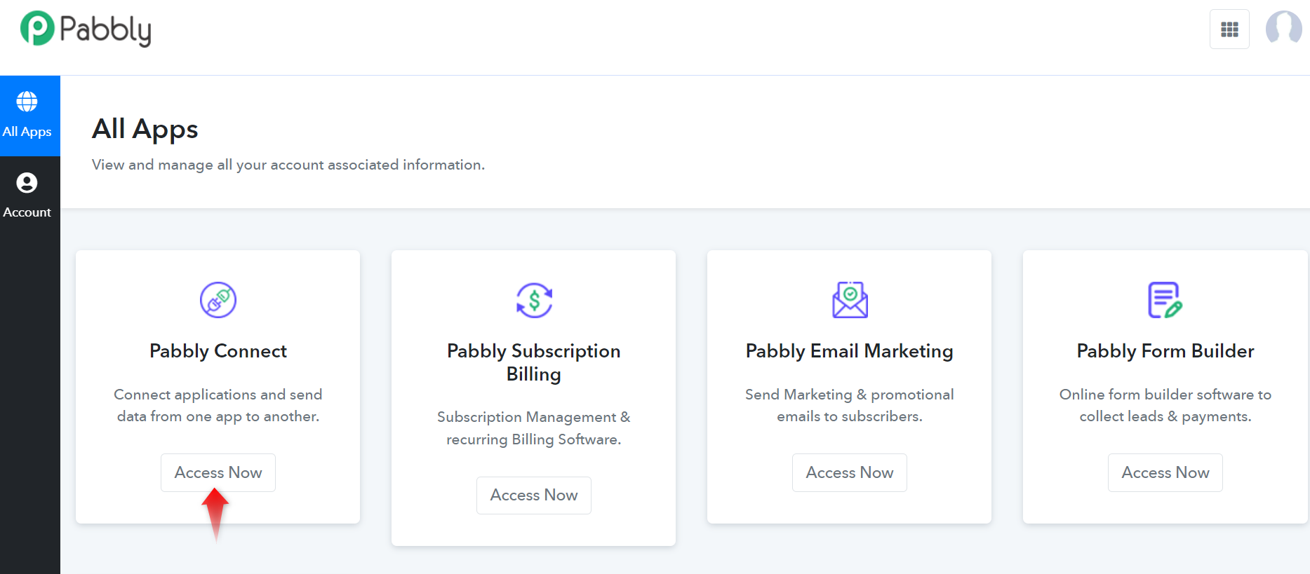

  • Go to your Account then select Pabbly Connect.

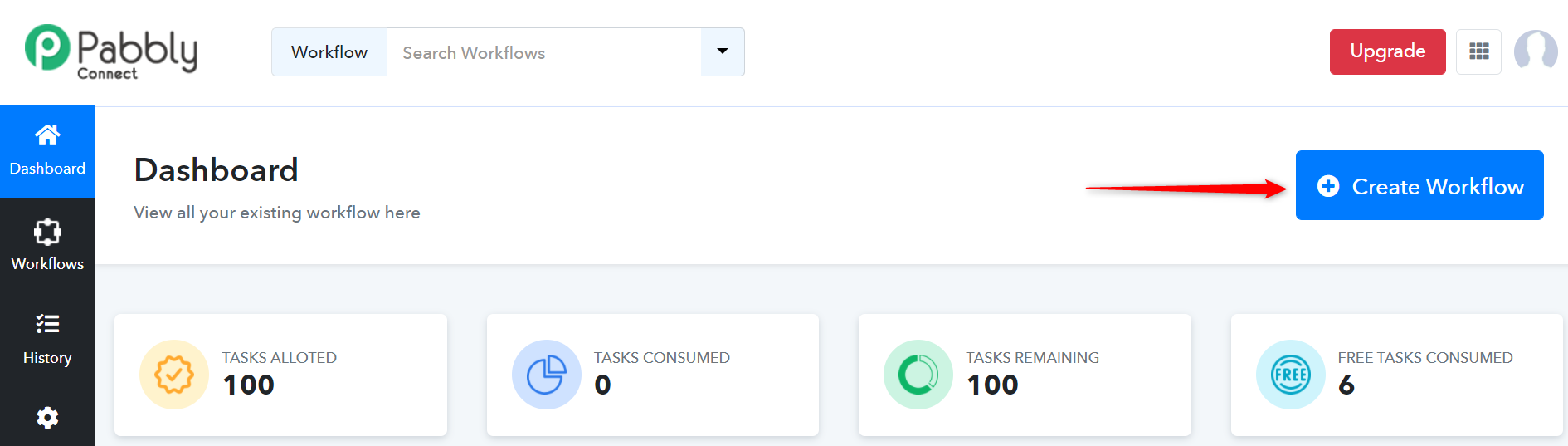

  • Create a Workflow under the Dashboard.

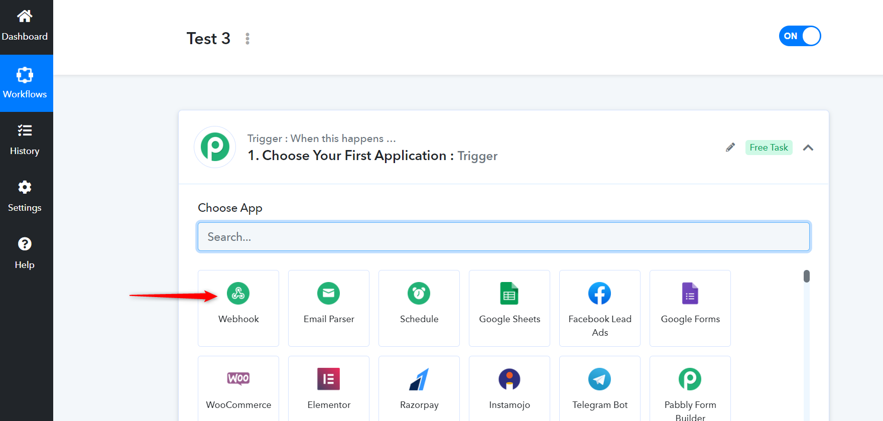

  • Choose the application which you want to Connect, in this case we will select Webhook.
  • Copy the URL given and paste this URL under Pabbly Subscription Billing in Webhook URL for getting notification.
  • Now if the event will be triggered, you will be notify once you will click on Capture Response.
  • You can also check the Details of notification of events triggered under History tab.
