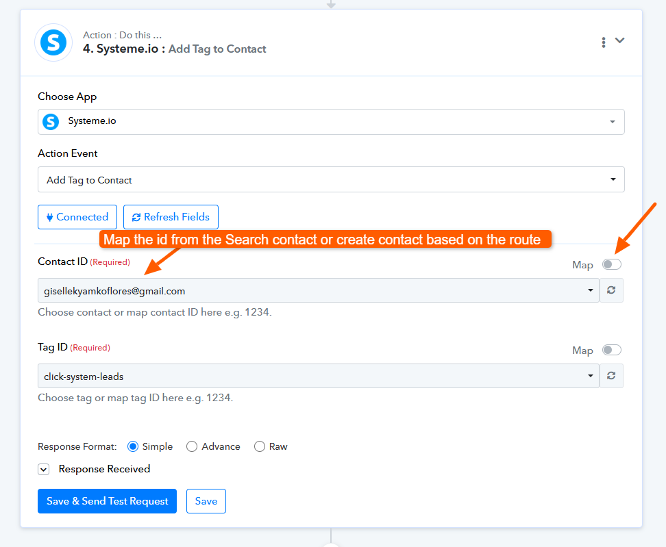

hello, I added a "Add tag to contact" step in systeme.io however the tag is not sending
Hi @Clicknamics,
Thank you for reaching out.
We reviewed your workflow and identified two issues causing the tag not to be added:
  1. Existing Contact Handling
    In some cases, the contact already exists, which is causing the workflow to fail. We recommend:
  • Add a Search Contact action before creating the contact
  • Use a Routerwith filters:
    • If Contact ID exists → directly use Add Tag to Contact
    • If Contact ID does not exist → first Create Contact, then Add Tag to Contact
  1. Incorrect Contact ID Mapping
    Currently, a static contact is selected in the Add Tag to Contact step. This causes the same contact to be tagged every time.
    To fix this:
  • Enable mapping for the Contact ID field
  • Map the Contact ID dynamically from either the Search Contact step or Create Contact step
Please update the workflow accordingly and test again. Let us know if you need any further assistance.

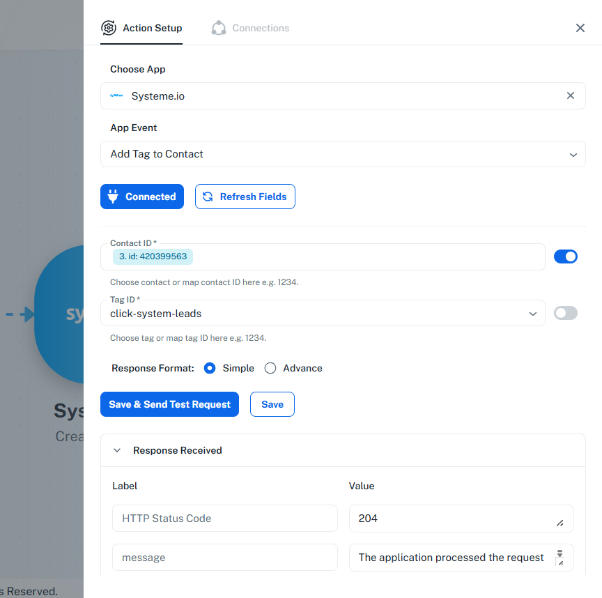

I use a new contact everytime I test, I updated already the workflow but still not working.
Clicknamics — Reply ·
Just wondering why the tag field does not exist in the systeme.io create contact step just like the fluent CRM create contact step.

Hi @Clicknamics,
We’ve updated the action.
Previously, the Contact ID was being mapped from the Fluent step, whereas it needed to be mapped from the Systeme.io Create Contact action. We have corrected this mapping.
Kindly check your Systeme.io account and confirm whether the contact is now getting assigned with the respective tag.
ok thank you it's now working
