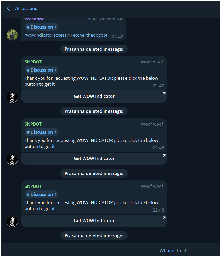

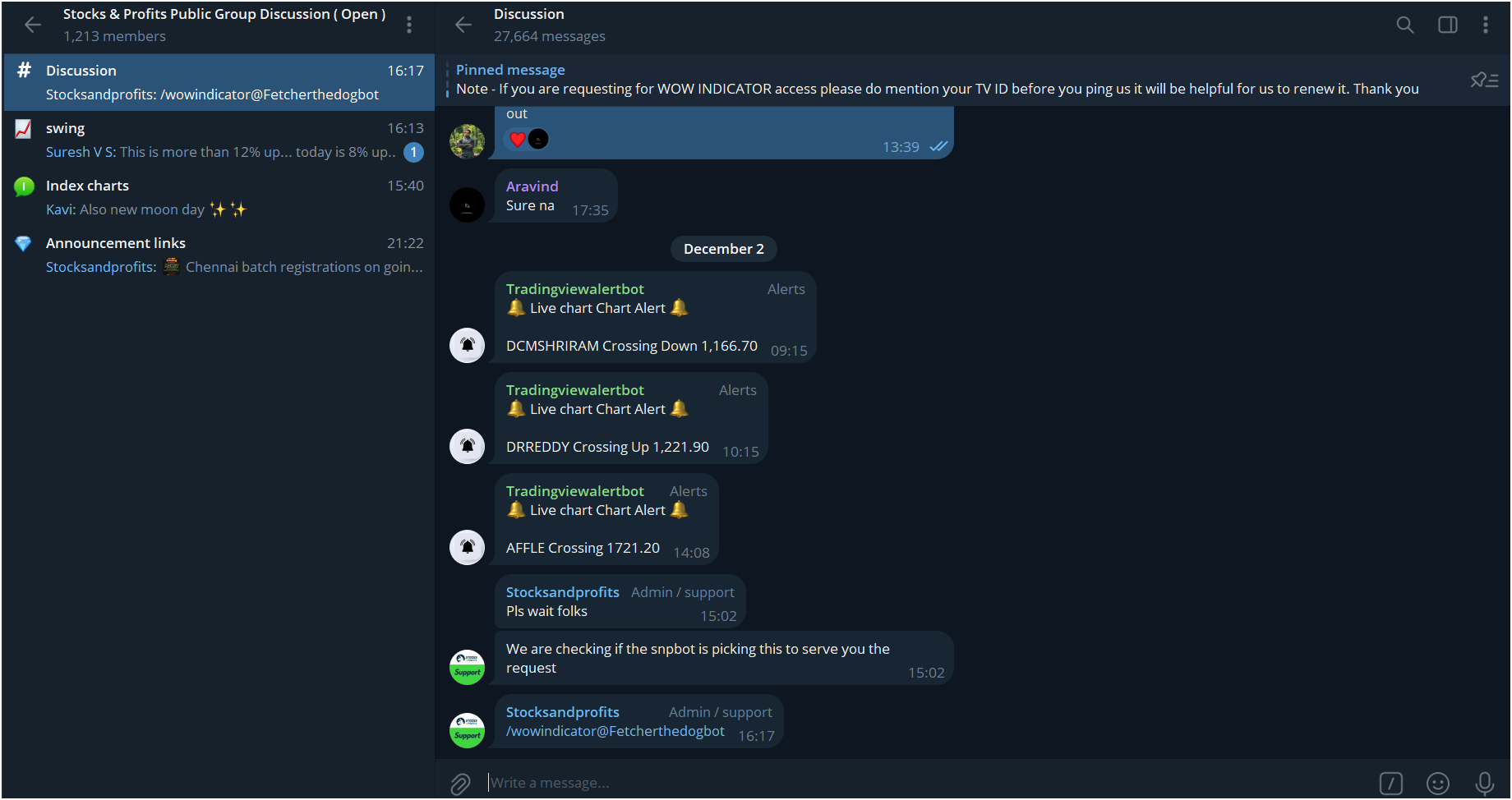

We configured a telegram bot and added it as admin in a group. and when the command for the telegram bot is triggered Pabbly connect sends a response back to the telegram group but the problem here is it send multiple times instead of single response.
Any ideas on how to solve this ? please see below screenshot

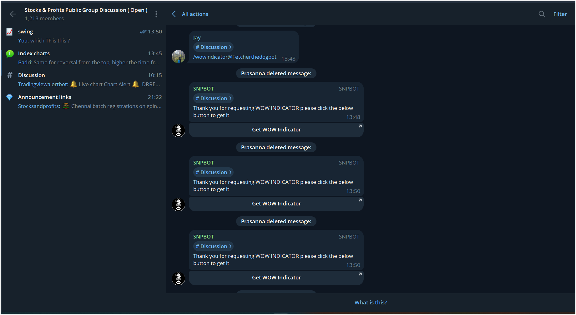

we made the below changes.
went in to bot settings and changed command1 to wowindicator.
when we asked one of our members to test but it is still triggering multiple times.
here is the screenshot.

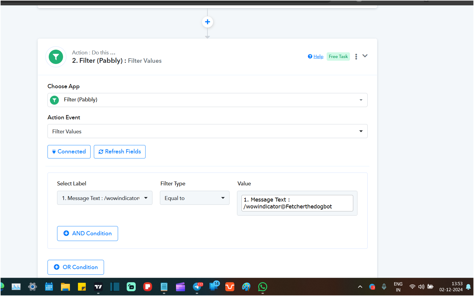

we did add the trigger step you asked us to do. and here is the screenshot for that.

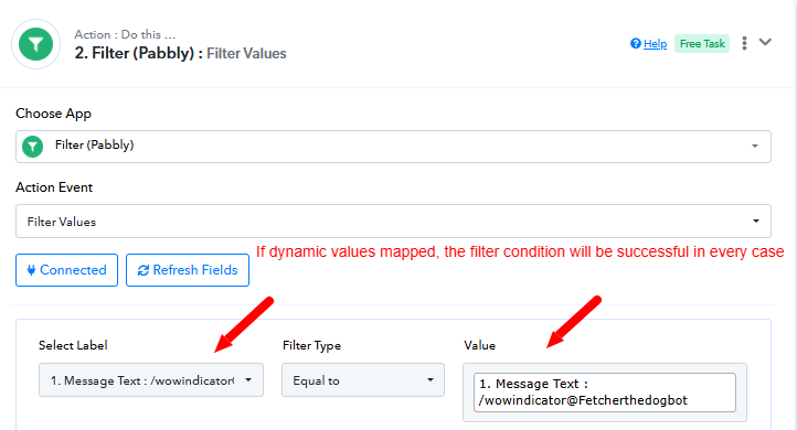

Hello @Stocksandprofits
The issue is occurring because you have mapped the dynamic response value in the value field. To resolve this, please add a static value as plain text instead of the dynamic value. This will prevent the workflow from triggering in every case and ensure it works as intended.
Let me know if you need further assistance!

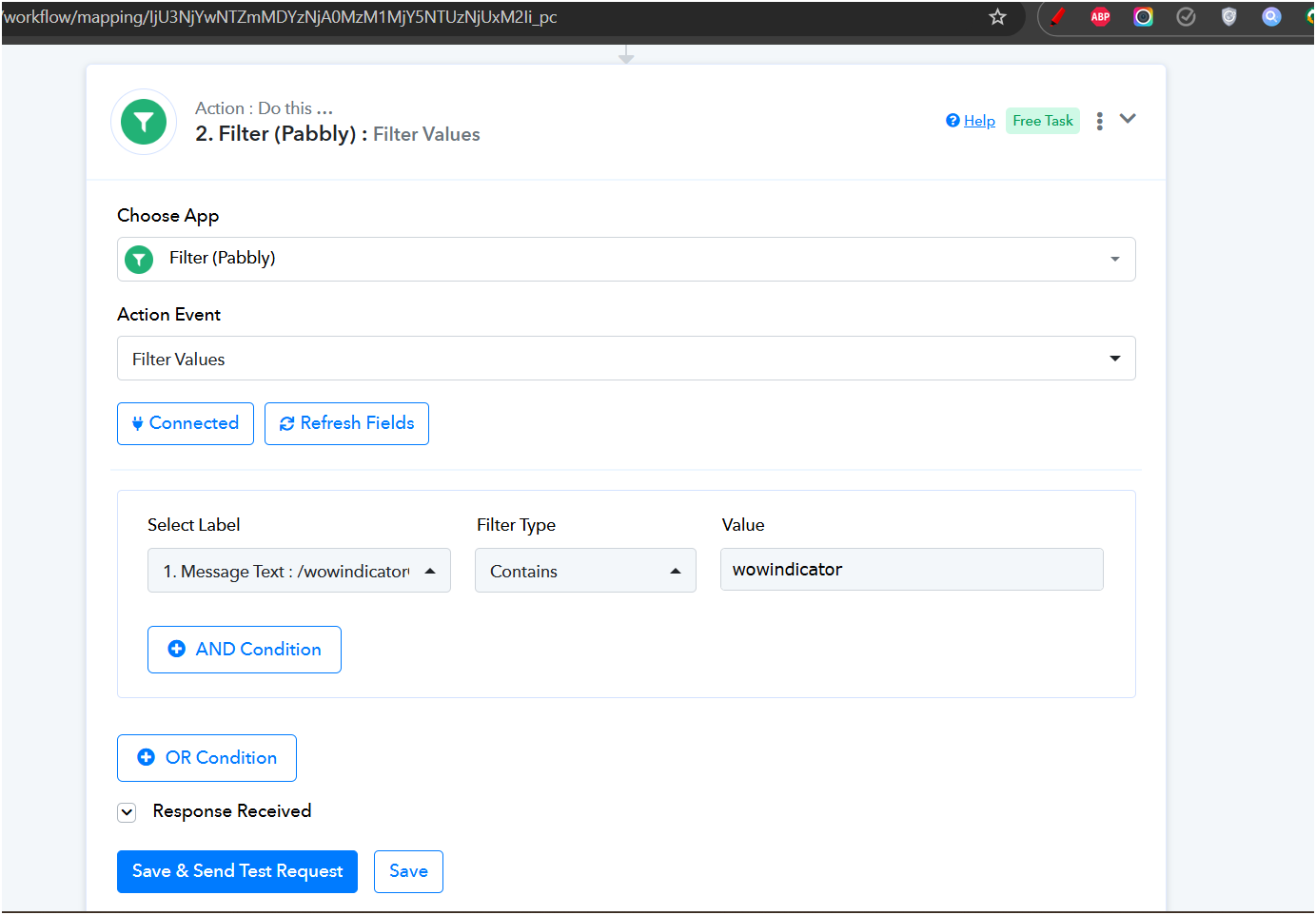

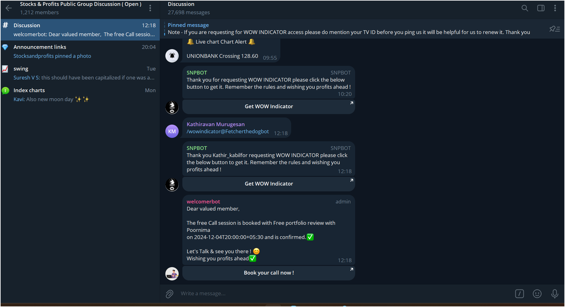

Alright we are back after the execution and exact steps you told to do. Here are the results.
We did the bot trigger which was done by 4:17pm and it did not respond back.
Please check the below screenshot

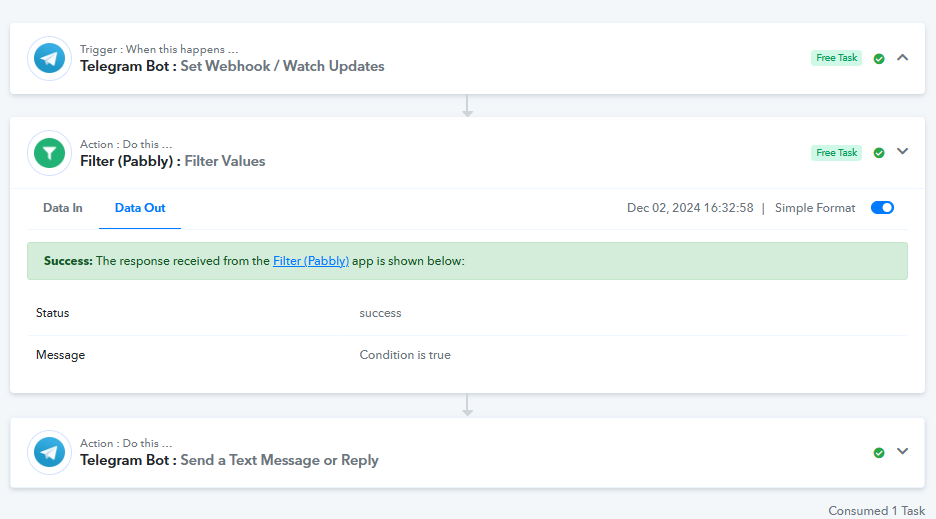

Task History ID - IjU3NjUwNTZjMDYzMzA0MzY1MjZkNTUzMzUxMzc1MTYxNTQzMTBmMzQi_pc
As per the above task history ID the Telegram message should have been sent. Can you please add a few more tests and let us know if it works for you if the message text contains the word wow indicator
Stocksandprofits — Reply ·
Thank you for your help Preeti, This is working fine now. I think we are good here.
