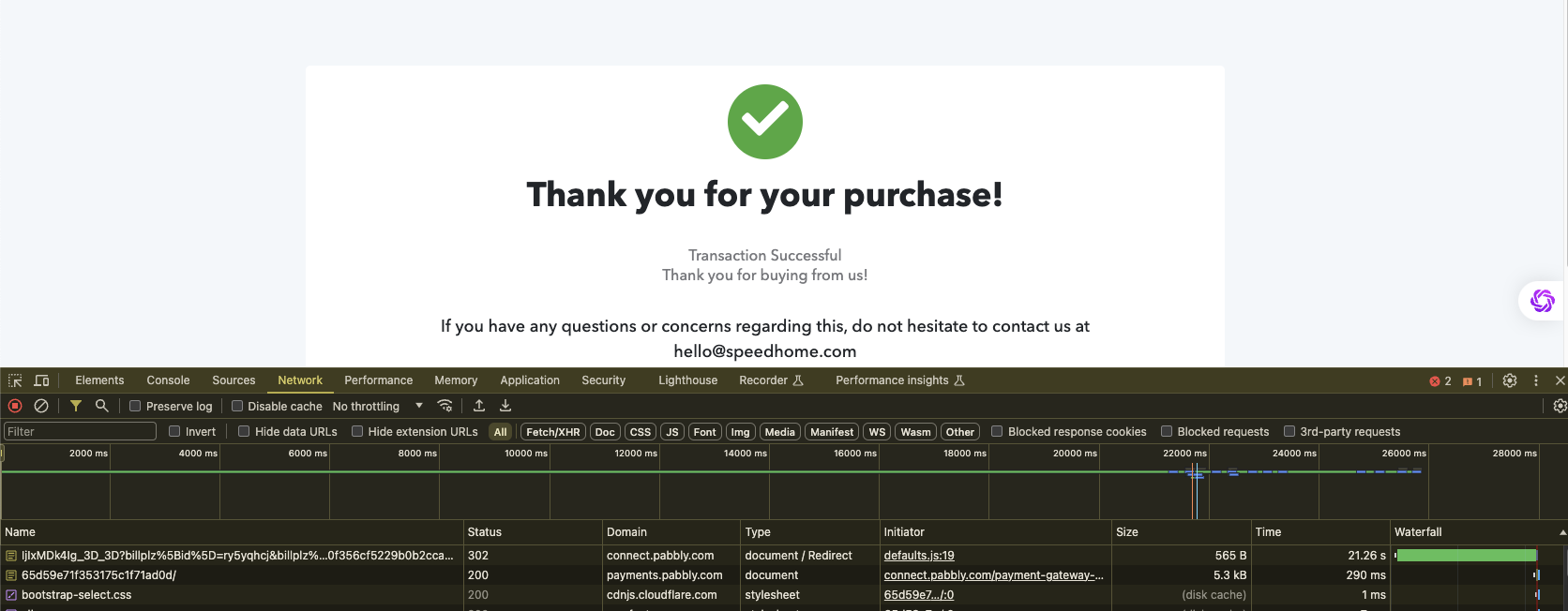

Unfortunately, we will not be able to attend the meeting tomorrow as it is weekend. Can we have meeting early next week ? Also for making debugging easy we have a screenshot which shows that connect.pabbly is actually taking some good time(around 21.26s) to redirect.

Hello @binaya ,
Our technical team has made some changes on our end to reduce the time taken for the thank you page redirection using the Billplz payment gateway, as discussed during our call. We kindly request you to test this by making a live payment and inform us whether the issue has been resolved. Your feedback will help us further investigate the matter.
binaya — Reply ·
Hello @MukeshR,
We have tested from our end. There is good improvement in the redirection speed. Thank you for your support !
