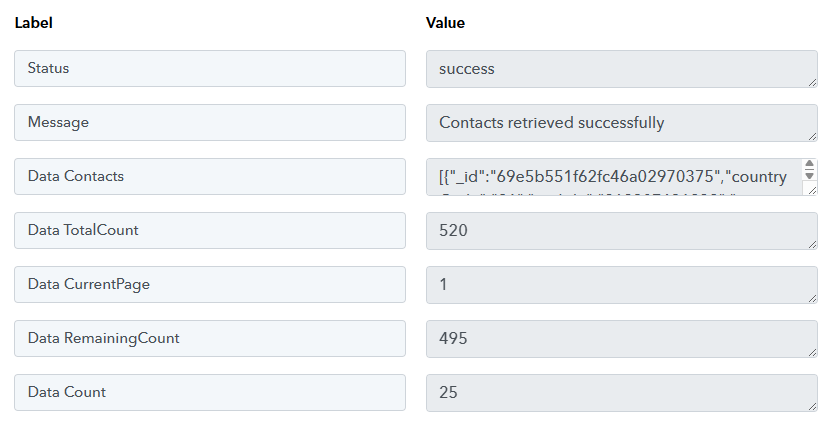

I am unable to fetch Contact ID using API Call for a specific mobile number,
It's giving output for only 1st 25 contacts out of complete contact list .
Using phone number or Attribute email, I want to extract Contact ID of a particular contact.
CONTACT ID is required to Updated a contact using Pabbly Chatflow Action Step,
Upsert contact tag doesn't triggers Flow automations, Only Update tags is triggering that, So I need the Contact ID of a particular contact to UPDATE contact on next step using Pabbly Connect
Currently I am trying with this -
https://chatflow.pabbly.com/api/v1/contacts/ & getting this output !
Hello DEH1,
Thank you for sharing the details.
It appears that the response already contains the Contact ID (_id). However, the endpoint you are using (/contacts) is meant for listing contacts, which is why it is returning a paginated list (e.g., 25 contacts) instead of a specific contact.

Currently, the response contains contact id for the initial 25 contacts. But what if the contact I want to search using the filter is my last contact in the list As a contact number 501.

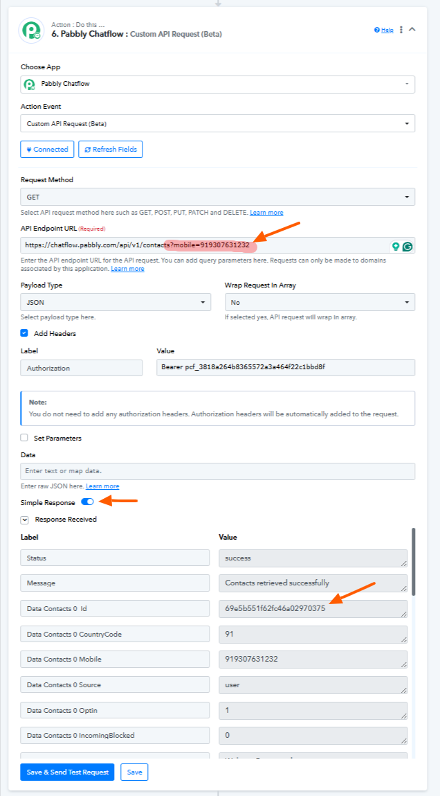

Hello @DEH1,
You can continue using the same endpoint and pass the mobile number as a query parameter (as you are currently doing). This will ensure that only the contact matching the provided phone number is returned in the response, along with its Contact ID (_id).

Problem with existing approach (list → filter → use Contact ID) Is that it is giving output only for the first 25 contacts How to get the output of all the contacts I have in my contact list In the api output, so that I can run the filter in the next step.

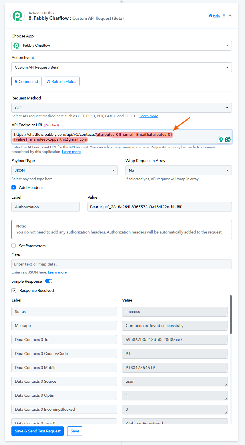

Hello @DEH1,
Thank you for your patience.
Our team has updated the API documentation, and it is now possible to fetch a contact using a custom attribute or custom field.
You can configure the action as shown in the shared image. This will allow you to retrieve a contact using the email address (configured as a custom field). Please ensure that you map the email address dynamically from a previous step in your workflow.
Feel free to reach out if you need any assistance with the setup.
