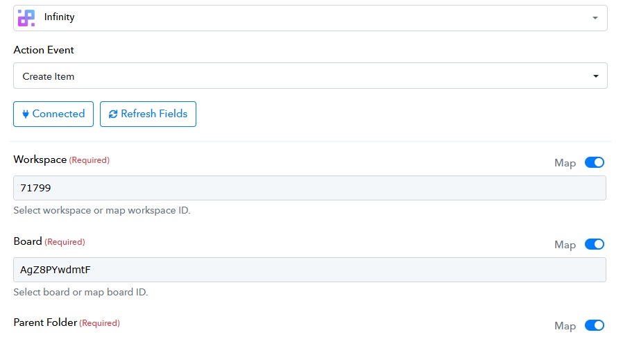

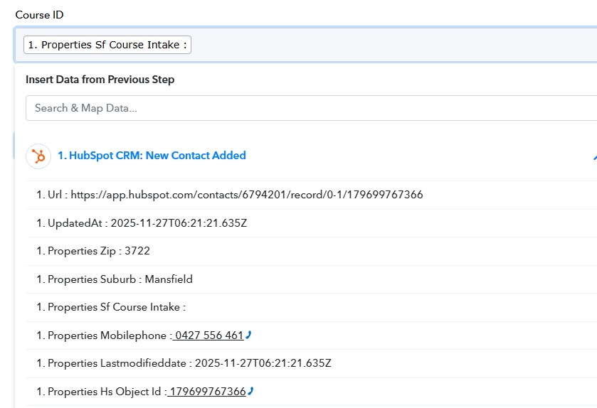

HI Preeti, sorry for late reply. While awaiting for your response, i tinkled a little bit with a second workflow where i toggled (Map button active) for the Workspace, Board and Parent Folder. from then on the data came in. In regards to finding the fields from HubSpot within the action trigger, it was a bit confusing as the fields were not showing up as expected, i had to make a choice from the dropdown menu, which was showing only one account retrieved from (trigger)previous HubSpot response. Confusing because i was expecting to see Hubspot fields only and was uncertain whether to select from the response showing up. At the end of the day i selected from the response lists accordingly and new contact is now coming from Hubspot to infinity.

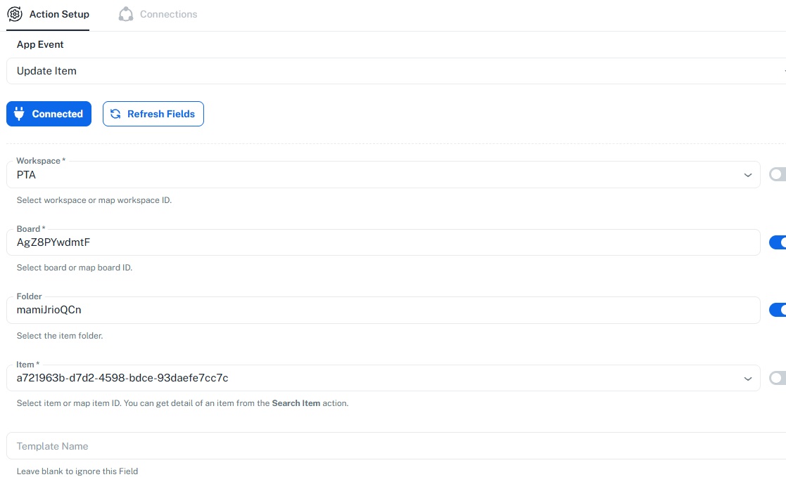

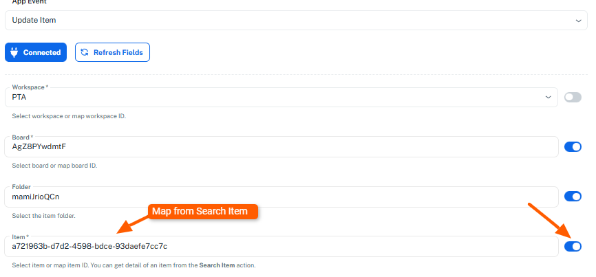

Now that contact details from HubSpot is coming in, i wanted to create another workflow so that any changes in HS for existing contacts ( which are now in Infinity) are replicated to infinity. I tried and came up with successful initial response test, but several modification were made in HS contacts to get real results but they did not come across. What is bothering me is that in the action trigger there is a field called "item" . This was not present when we created the workflow to create contact on previous request. On this workflow (to update contact) , it's here and mandatory. I am unable to distinguish what is is related to as it all numbers and letters, even when toggling the mapping button. I can see there is a list of other similar type of characters when trying to select that field. I am guessing one one them may solve my contact update sulution. Your expert advise please.
Workflow: https://connect.pabbly.com/v2/app/workflow/mapping/IjU3NjcwNTZkMDYzNjA0Mzc1MjZiNTUzMjUxM2Ei_pc
Hello @PTA,

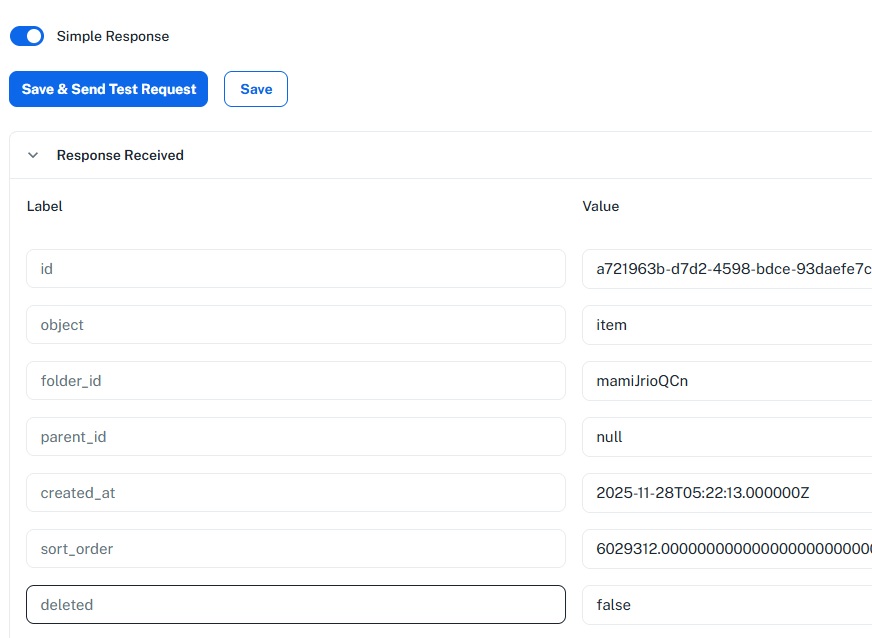

To update an existing contact in Infinity, you will indeed need to provide the Item ID, which is why the Item field is now showing as mandatory in the update action.
Since HubSpot does not send the Infinity Item ID directly, you would first need to locate the corresponding item in Infinity. For this, please use the Infinity: Search Item action in your workflow. Pass the relevant details coming from the HubSpot trigger (such as email or any unique identifier). This action will return the specific Item ID from Infinity.
Once you receive the Item ID, enable Map on the Item field and map the returned ID there. After this setup, any future contact updates from HubSpot will correctly update the matching record inside Infinity.

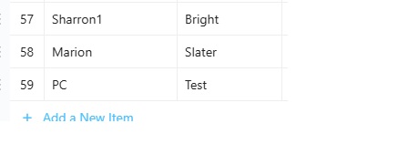

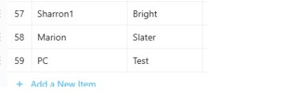

Hi Preeti, i can see a test field was created in infinity and guessing it may be from your side. Hope i am correct. Also noticed workflow changes made, which looks interesting. Thanks for looking into these, really appreciate. I shall be away from computer on and off and will definitely keep you updated after more testing. That really helps, as i was getting discouraged , and now motivated again. Thanks again . attached is contact sharon that was created from intial HS as new contact, this was populated to infinity from existing new contact created workflow. As a test for testing updated contact from HS i added the number 1 to check if my workflow would work. It did not, but after your changes on my workflow , it worked.

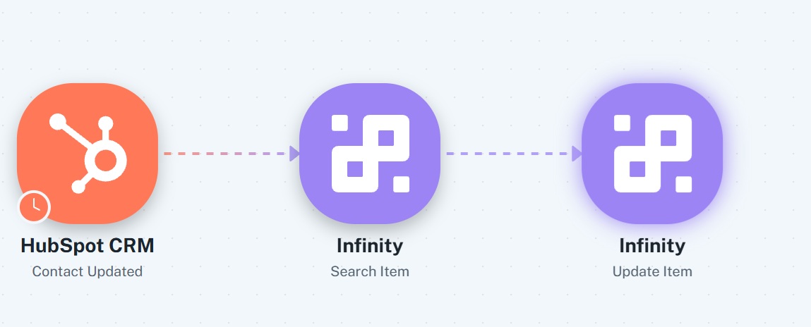

Now that i am looking at the workflow and reading your previous response , i see what you meant by " infinity: search item". I was trying to figure out where to do that on the action trigger . Now it makes a lot of sense.

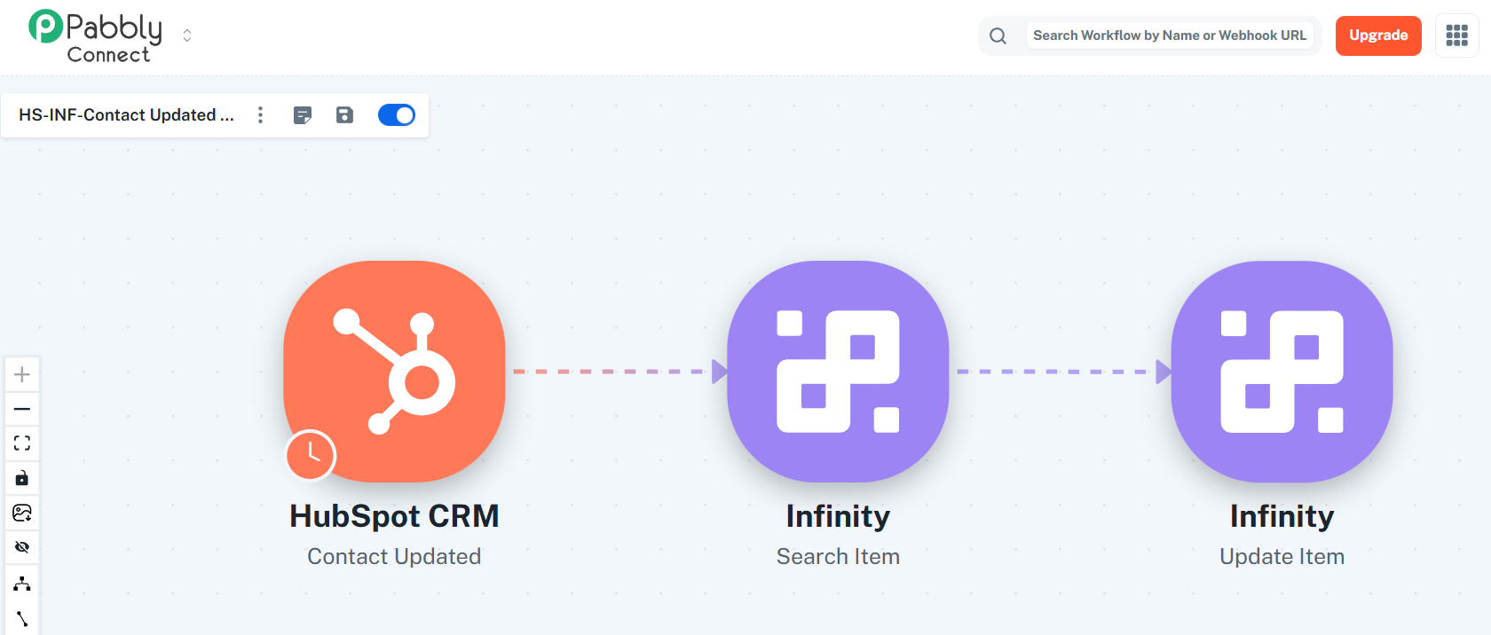

We have added a ‘Search Item’ action step to your workflow, which will return the Item ID associated with the email address of the item added to your Infinity account. We have also mapped the Item ID from this step to the ‘Update Item’ action step on your behalf.
Please note that this workflow will work only if the contact updated in HubSpot already exists as an item in your Infinity account. If the item does not exist, or if the updated field in HubSpot is the contact’s email address, then the item will not be updated in Infinity. This is because the item is being searched by email address, and if an item with the same email address is not found in your Infinity account, it cannot be updated
PS: To set up the ‘Search Item’ action step, we added an item with the email address ‘[email hidden]’ to your Infinity account. You can delete that item.
We can modify your workflow so that when a contact updated in HubSpot CRM does not exist in your Infinity account, a new item will be created, and if it does exist, the item will be updated. If you would like us to make these changes to your workflow, please let us know and we will do it on your behalf.

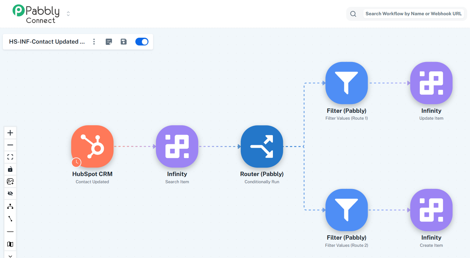

My ideal scenario is to have any contacts in HS whose fields are modified are replicated to Infinity.
(first name, lastname ,address etc).
Create them in infinity if they are not when their details are changed in HS.
Also is there a possibility of doing the opposite ( from Infinity to HS), this will make my day.
Hi Arshil, great work.
We have added a Router to your workflow, which will allow you to create or update items in Infinity from HubSpot.
I’m afraid this particular use case is not possible or recommended, as it will create a loop. Infinity will update the contact in HubSpot, and HubSpot will update the item in Infinity.

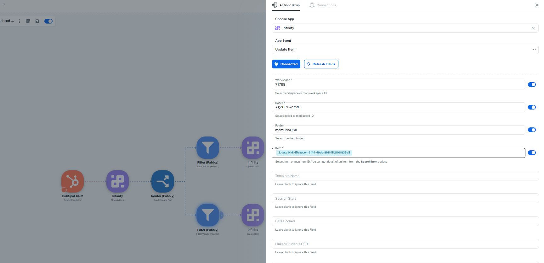

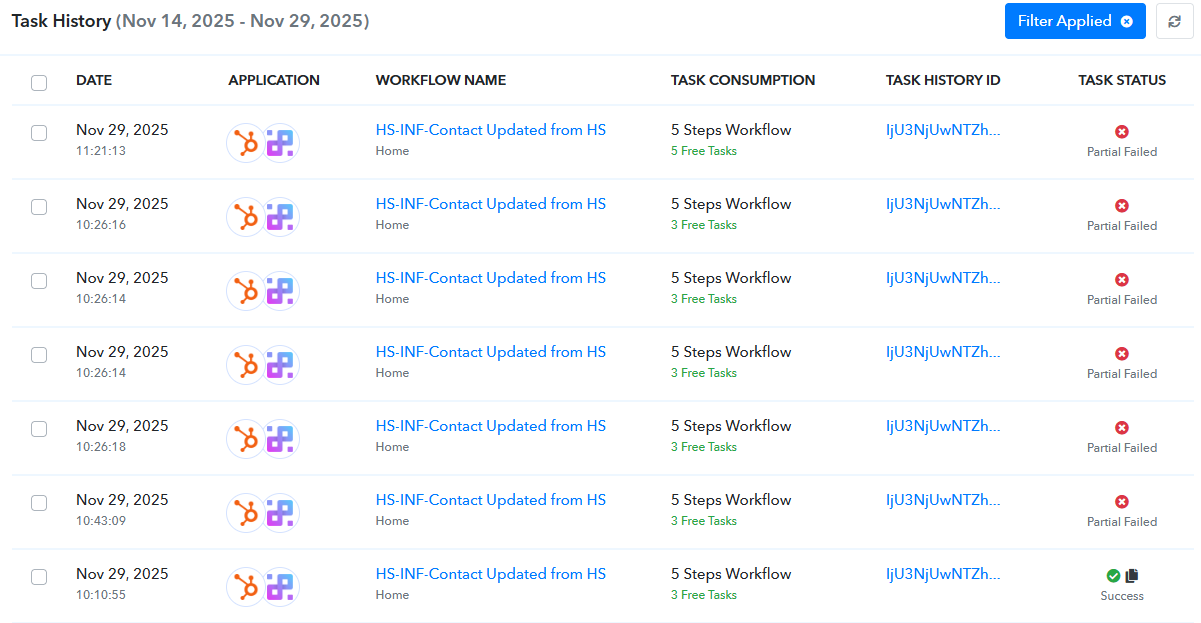

Hi, i came back and check after a while and still some errors.
Sorry to be a pain

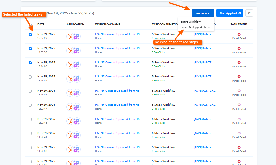

Hey @PTA,
It seem you haven't mapped the ID from the Search Item action in the Update Item action, we have mapped it on your behalf. You can re-execute the failed tasks and this time they should go through.
