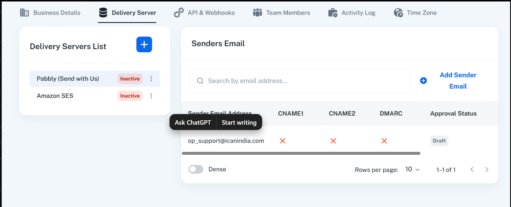

We are facing an issue while configuring the email delivery server in our Pabbly account.
Our sender email address [email protected] has been added, but the verification status is showing the following:
  • CNAME 1: ❌ Not Verified
  • CNAME 2: ❌ Not Verified
  • DMARC: ❌ Not Verified
  • Approval Status: Draft
  • Delivery Server Status: Inactive
Due to this, we are unable to activate the delivery server and send emails.

I have attached a screenshot of the issue for your reference.

After reviewing the details, we found that your sender email is still in Draft status because the required DNS records (CNAME 1, CNAME 2, and DMARC) have not yet been verified. As a result, the Delivery Server remains Inactive.

We have already added the required DNS records as per the instructions shared. Please find the attached screenshots of our DNS configuration for your reference.

Despite adding these records, the sender is still showing as Draft, and the Delivery Server remains Inactive.
Could you please verify the DNS records from your end and let us know if there is any issue or if any additional configuration is required? We would appreciate your assistance in activating the sender.
