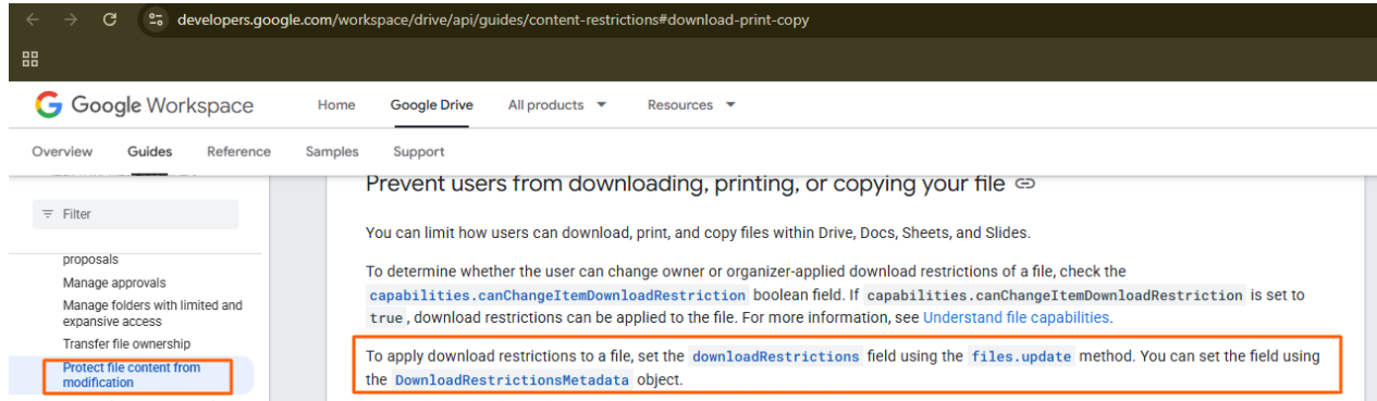

The recommended and current way to restrict downloads (along with print and copy) for viewers and commenters via the Google Drive API v3 is to use the downloadRestrictions field in the File resource.API endpointPATCH https://www.googleapis.com/drive/v3/files/{FILE_ID}Request body (JSON) to restrict download
json
"downloadRestrictions": {
"itemDownloadRestriction": "restrictedForReaders"
  • This disables download, print, and copy options for readers (viewers) and commenters.
  • Buttons are typically hidden or non-functional in the viewer.
Alternative (legacy field, still supported but not recommended for new implementations)
json
"copyRequiresWriterPermission": true
  • This achieves a similar effect (disables copy/print/download for non-writers).
  • Official docs recommend migrating to downloadRestrictions for better granularity and future compatibility.
Key notes (as of 2026)
The downloadRestrictions approach is the modern, preferred method for precisely this purpose. If you need code samples in a specific language, let me know!

Yes, you can achieve this using the API (Pabbly) module in Pabbly Connect.
You need to run a PATCH request on the Google Drive API using the files.update method and pass the downloadRestrictions parameter to restrict download, print, and copy for viewers/commenters.
Reference (raw link as requested):
https://developers.google.com/workspace/drive/api/guides/content-restrictions#download-print-copy
Once this API call is configured correctly inside the Pabbly API module, the restriction will be applied to the uploaded file.

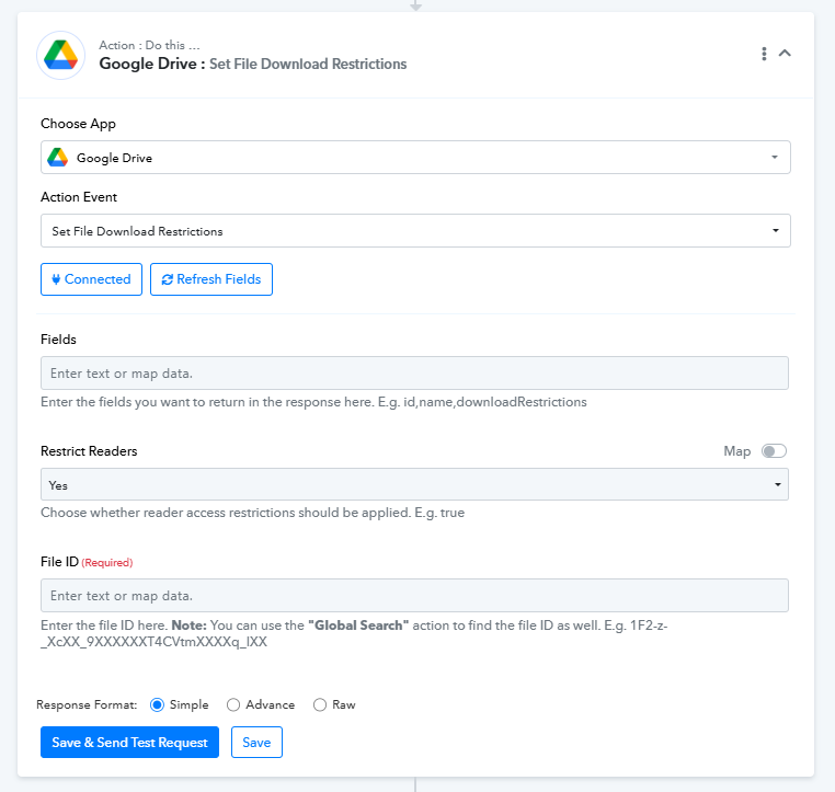

Hello @ichilddev,
Our team has introduced the action named Set File Download Restrictions using which you may acheive this use case.
