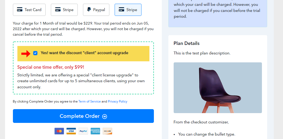

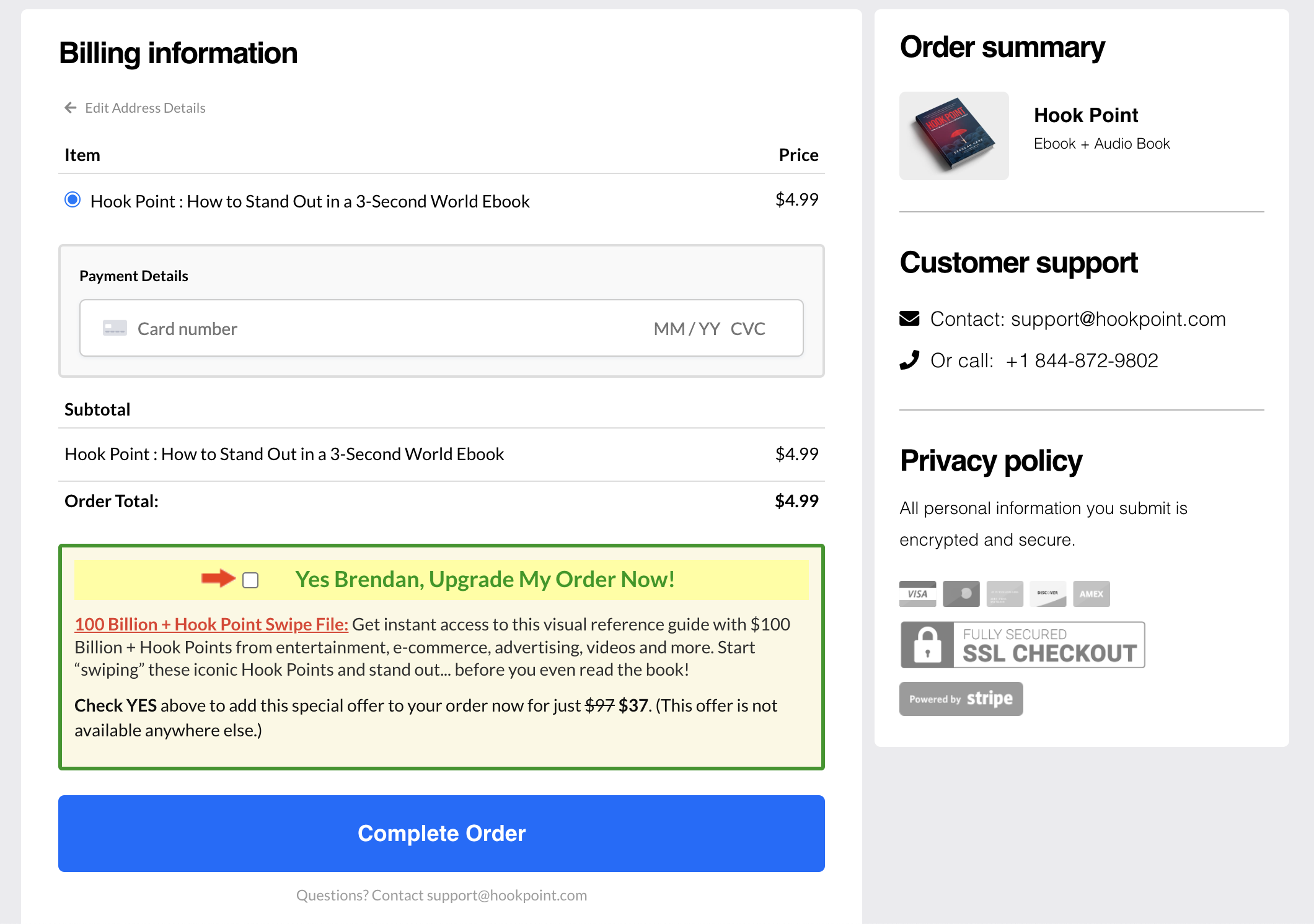

I'd love to have an upsell like this.
Is there a way to do this in Pabbly?

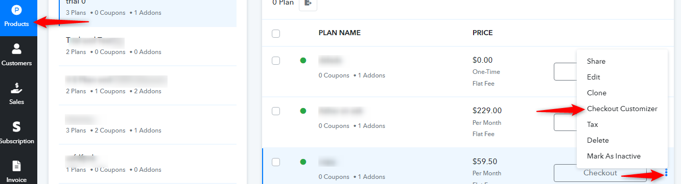

We would like to inform you that you can attach any of your Addon to the Bump Offer in Addon As A Bump Offer option ion Bump Offer under Checkout Customizer then it will reflect on the Checkout Page as Bump Offer.
For this, first you have to create Addon for the particular Plan in which you want attach the Bump Offer.

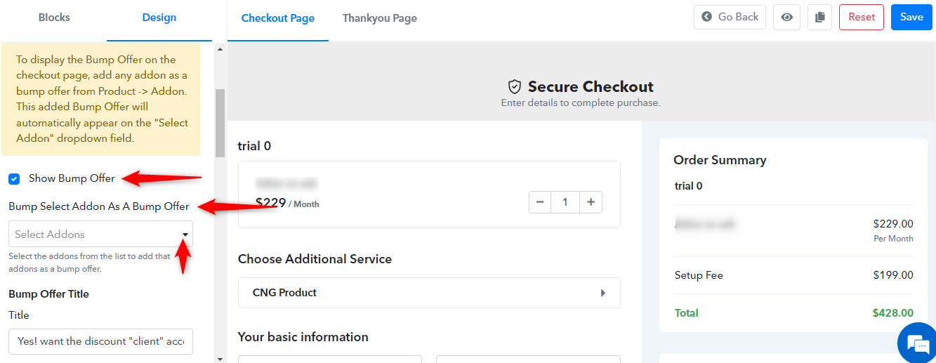

Product >> Plan (Click on 3 dots) >> Checkout Customizer >> Bump Offer >> Show Bump Offer (Click on the box) >> Bump Select Addon As A Bump Offer.
Rest of the fields you can adjust according to your requirements.
Once you will fill up the required fields the please save the changes through Save Changes option before going back.
Once you will made the all changes then it will look like :

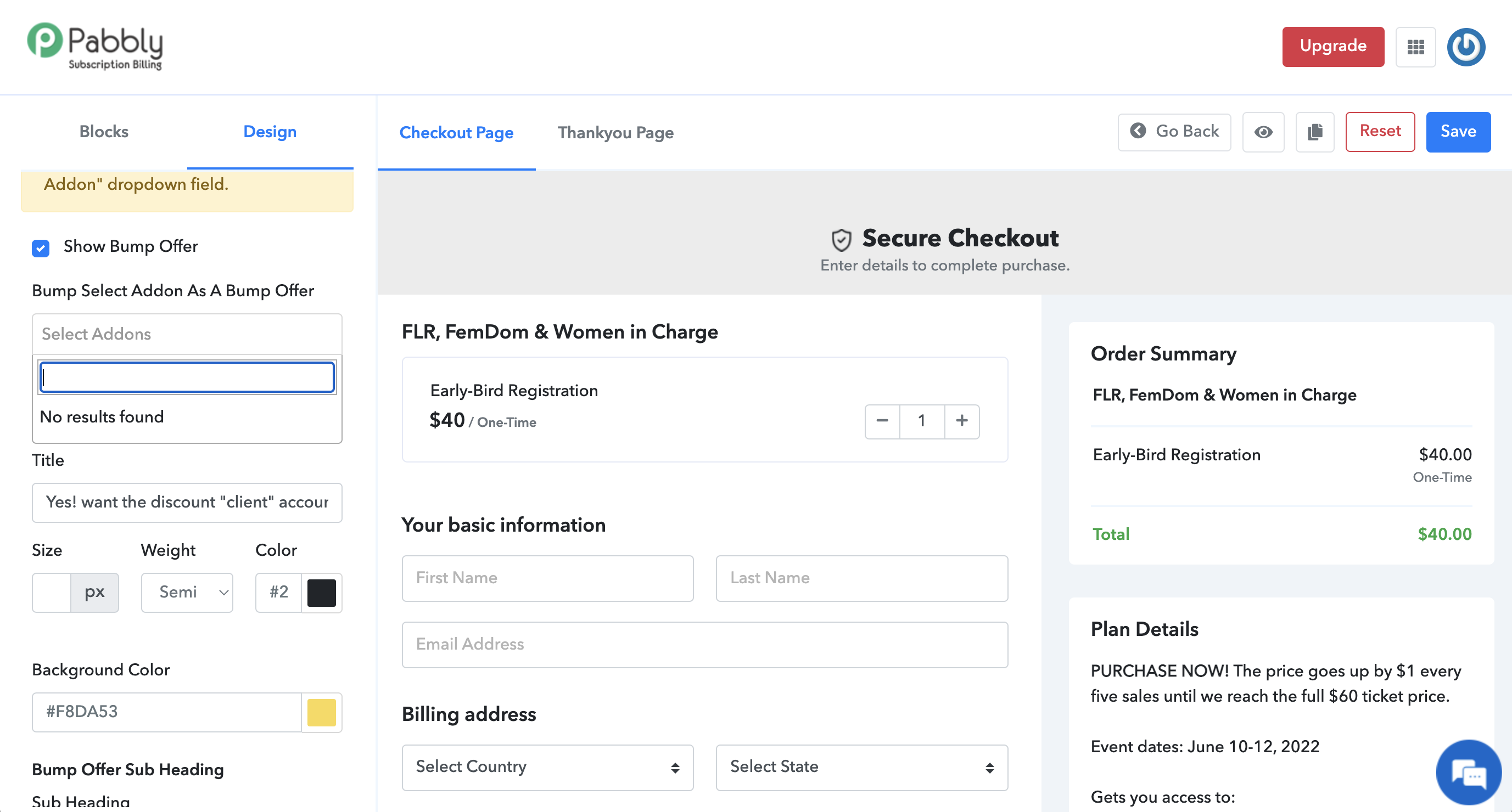

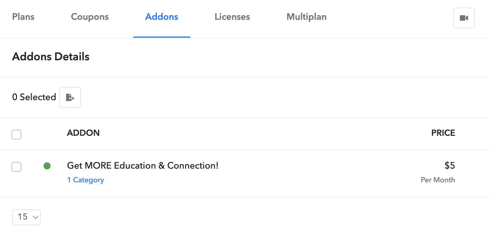

I've created an addon. It's active. But it's not showing in my "Bump Offer" drop down. I've tried a hard refresh. Any other tips?
Vipin Mishra — Reply ·
Hello MissNookie,
We would like to inform you that the Addon which you have created is Recurring while your Plan is Onetime so your Plan is not reflecting the Addon in the Select Addon field (Bump Select Addon As A Bump Offer) since Recurring Addon works with Recurring Plan and will not work with Onetime Plan.
Note : Onetime Addon will work with both Recurring as well as Onetime Plan but the Recurring Addon will only work with Recurring Plan.
