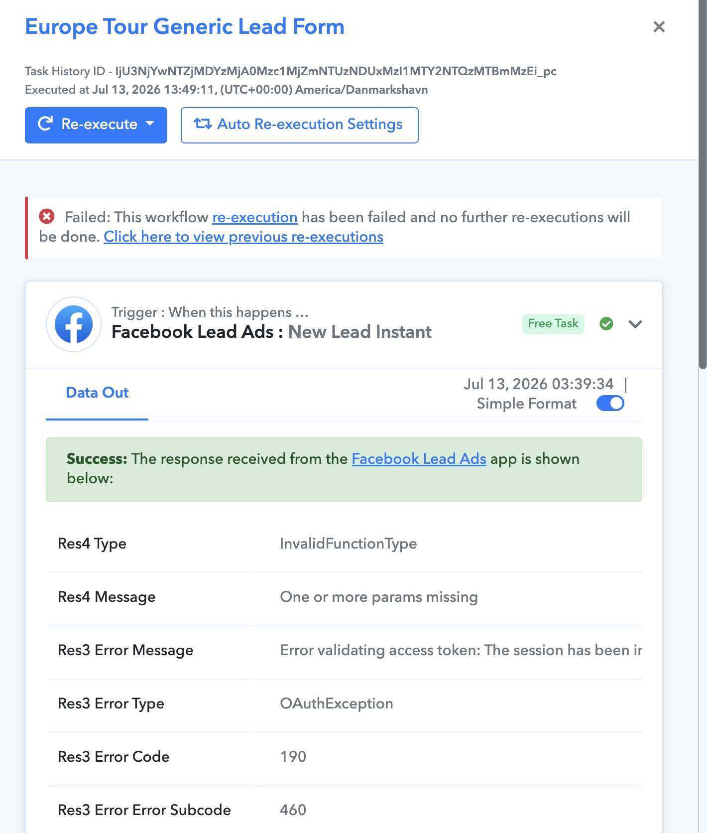

We are facing an authentication-related issue in one of our Pabbly workflows, due to which leads are not being forwarded from Facebook Lead Ads to our CRM.
This issue has been occurring since 25th June, and because of this, a significant number of leads have failed to sync with our CRM.
Issue Details
Workflow: Facebook Lead Ads โ†’ Pabbly โ†’ CRM
Issue Started: 25th June
Impact: Leads are being successfully received by Pabbly from Facebook, but Pabbly is unable to forward them to the next step due to an authentication failure.
Error Message
"Error validating access token: The session has been invalidated because the user changed their password or Facebook has changed the session for security reasons."
From the workflow logs, we can see that:
Facebook Lead Ads trigger is receiving the lead successfully.
The workflow execution fails during the forwarding process.
The error is related to an OAuthException (Error Code: 190, Error Subcode: 460) indicating an invalid or expired Facebook access token.
For your reference, I have attached a screenshot of the workflow error.
We have already verified and corrected our lead forms, so the forms themselves are functioning correctly. The issue appears to be on the authentication/token validation side within the Pabbly workflow.

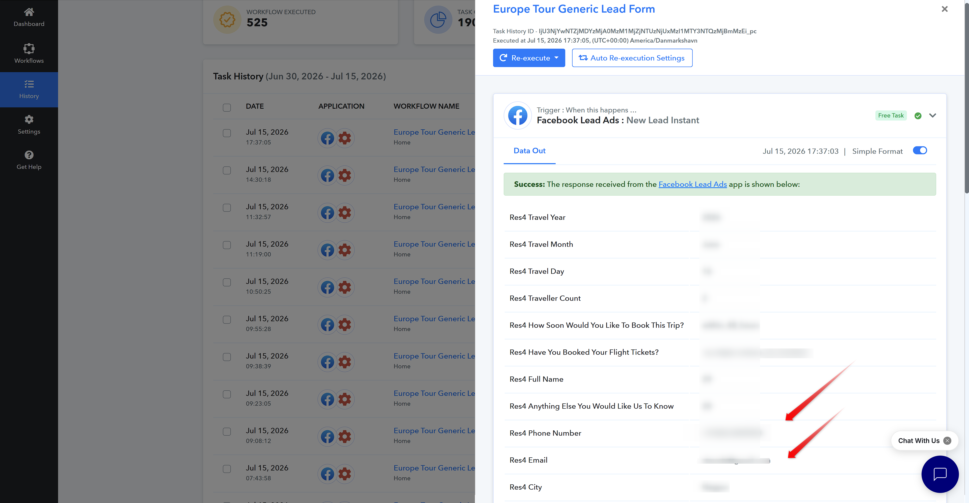

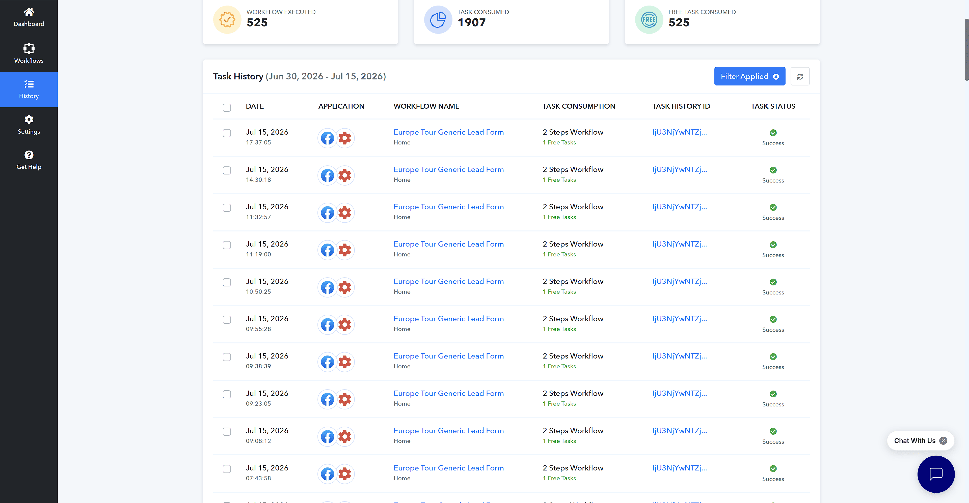

Pabbly Support โ€” Reply ยท
Hello Nitish,
We checked the workflow "Europe Tour Generic Lead Form" and the task history of the workflow, the workflow is now executing normally and the leads are being fetched after the credentials are updated.
2026-07-16_03h28_50.pngThe Trigger contains full Lead data, which was not being received due to an invalid token, as you updated the connection, a new token has been generated. Try using the same Facebook connection in all the workflows.
Adeel Akhtar
