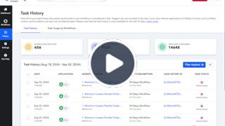

What happened? See this video please:
https://share.zight.com/8LueZR2L

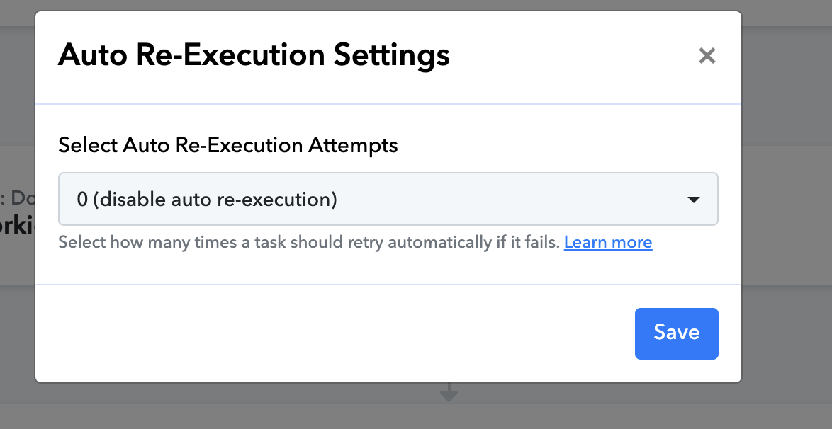

Now I have turned off auto execution but it was only set to run 1 time (which is the default). How do I make it stop? It spams calls!
I turned off the flow now but the moment I turn it on it just explodes and have eaten thousands of my credits on Pabbly as well.

But if Pabbly is not the fault how come it stopped when I disabled the retry execution feature of Pabbly?
Hello @apps
It could be the queued data that has been sent by the application, we recommend using https://webhook.site to check whether you are getting multiple responses there as well.

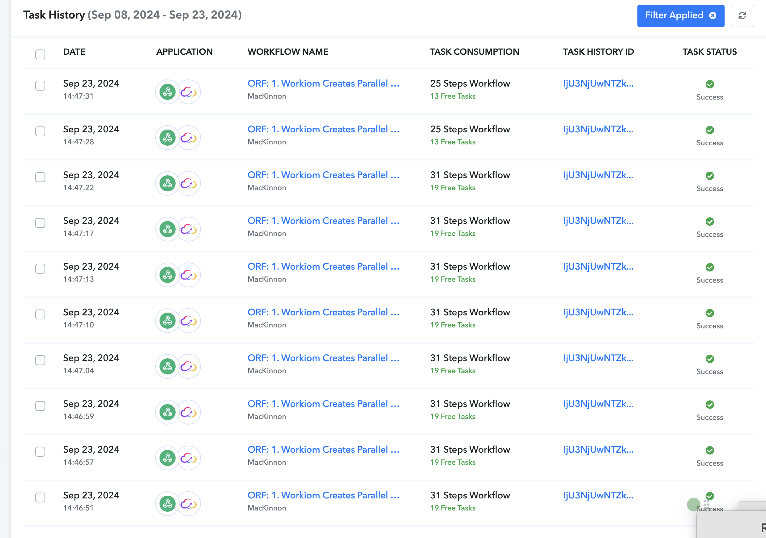

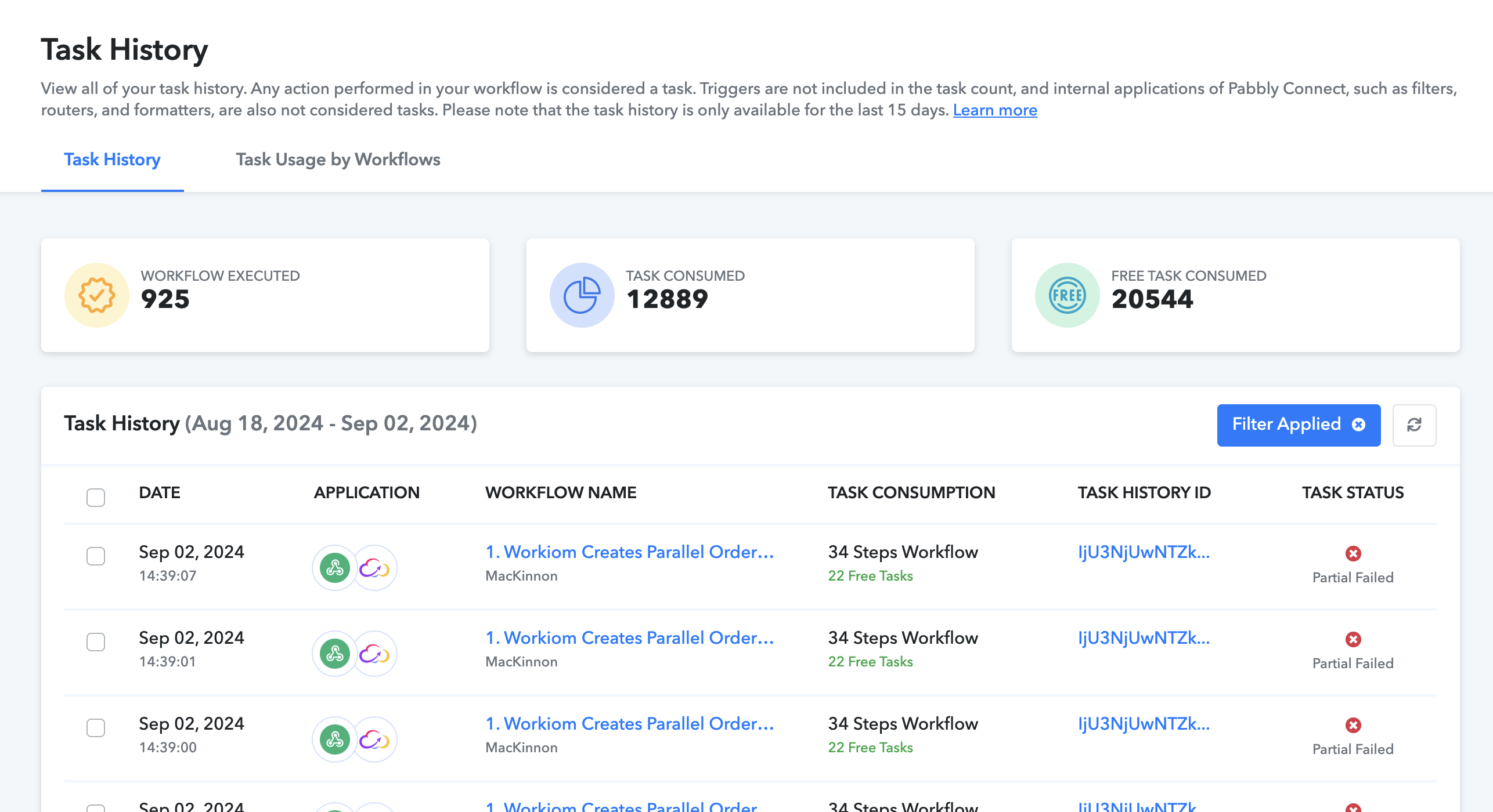

It happened again and again it burned off 85% of my monthly credits on parallels when the flow was activated succesfully once. I HAD turned off auto-execution. This has got to stop. See here:
Task ID:
IjU3NjUwNTZkMDYzNTA0MzI1MjZiNTUzMDUxMzU1MTYwNTQzMzBmMzki_pc
This is not Parallel doing it - it is Pabbly. The only way to stop this was to turn off the flow entirely. but 85% were burned of my Parallel credits
This flow: https://connect.pabbly.com/workflow/mapping/IjU3NjUwNTY5MDYzZTA0MzQ1MjZiNTUzZDUxMzIi_pc
See how it runs every 3-4 sec. And this is off:

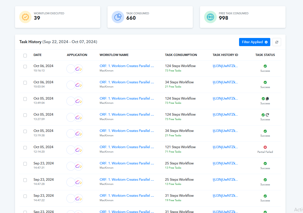

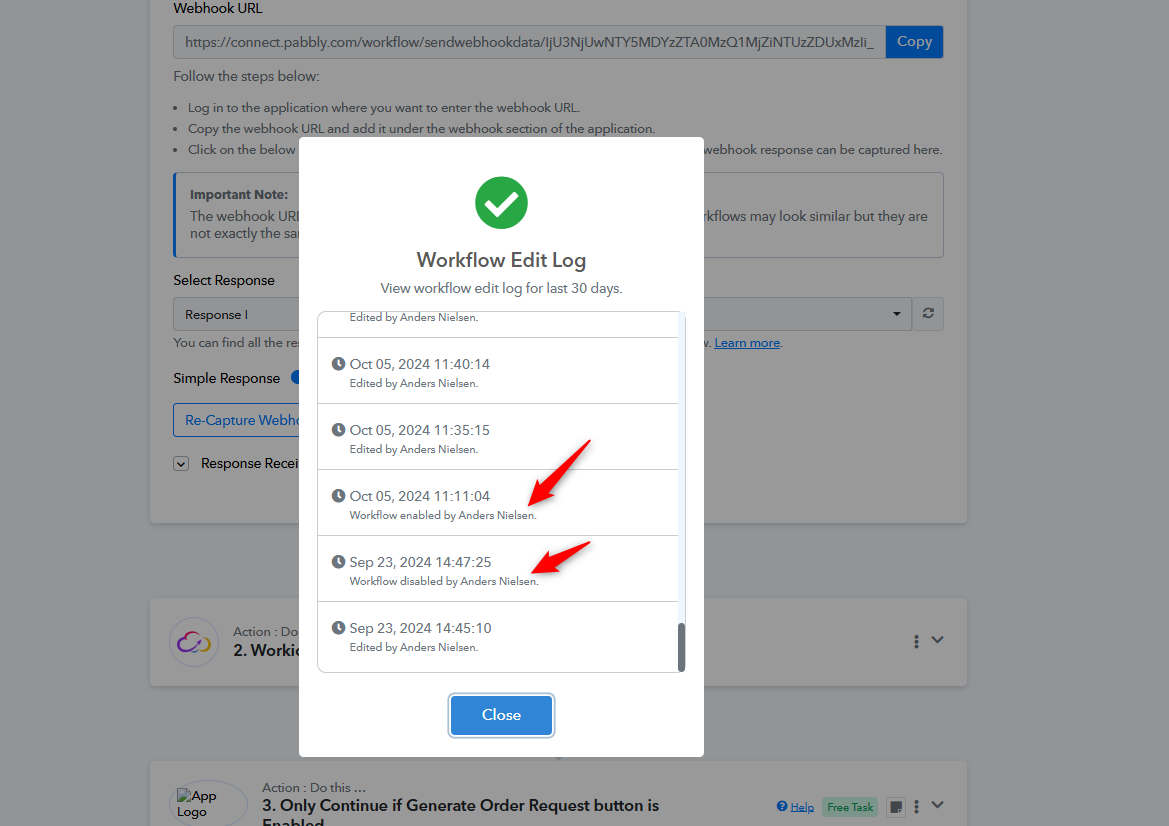

Hello @apps
As we have checked the workflow, we noticed that the workflow was disabled from 23 September to 05 October and as shown in the attached screenshot the workflow has got triggered as it got enabled. Please refer to the attached images for more info.
We would recommend you monitor the workflow and if you still face the issue please follow the previously suggested workaround to to check the responses from the trigger application.
