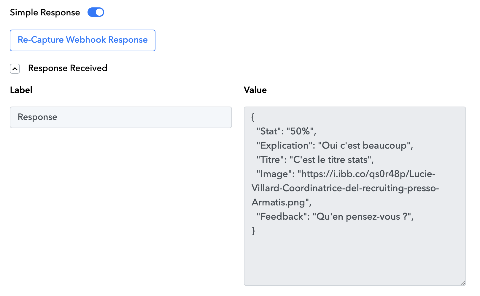

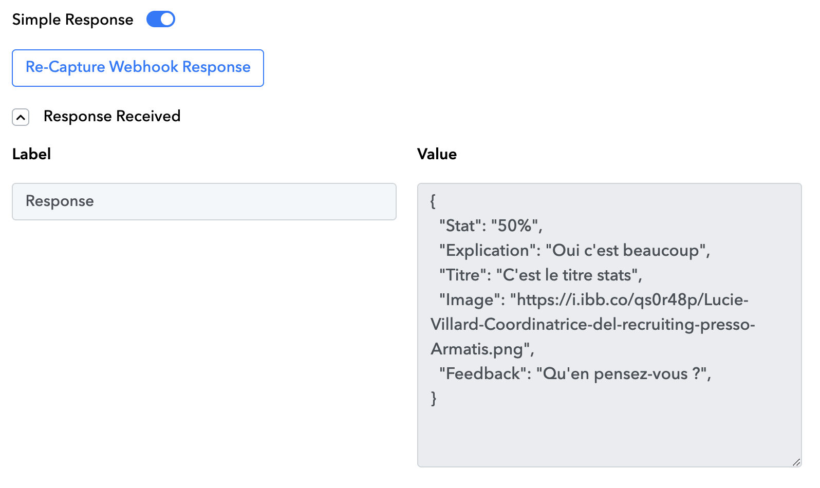

Your webhook catching got problem :
As you can see here, response are now wrapped inside 1 property "Response", not one by properties

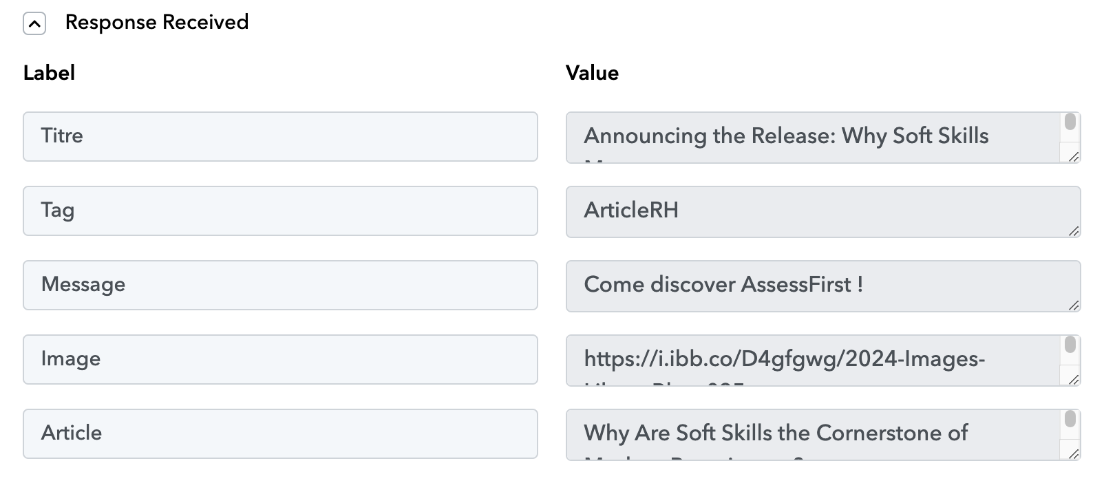

Normal behaviour:

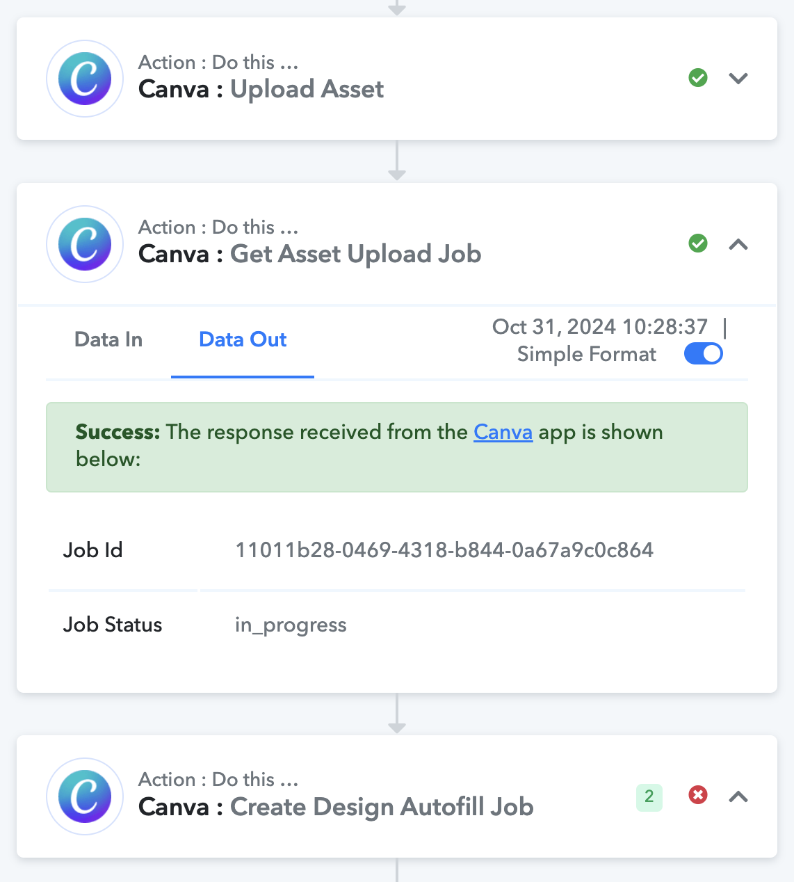

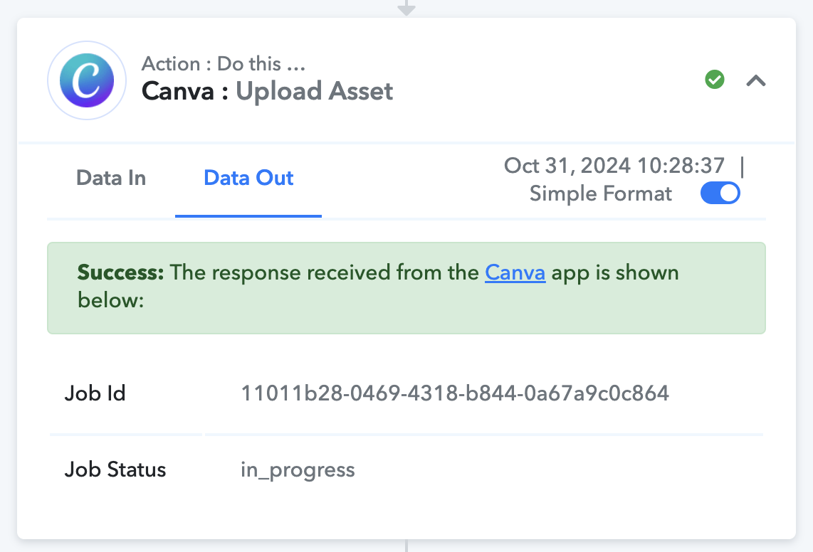

Your module doesn’t wait long enough before returning a success status.
The execution is still in progress and hasn’t completed.
Could you please fix this today, as you did for the same issue on “Create Design Autofill Job”? (Juste by adding more time execution on that module)

This one and others for Webhooks problem (first step) :
- https://connect.pabbly.com/workflow/mapping/IjU3NjYwNTZjMDYzNTA0M2M1MjZiNTUzMTUxMzYi_pc
And all step like this one for Get Asset Upload :
- https://connect.pabbly.com/workflow/mapping/IjU3NjYwNTZjMDYzMjA0MzQ1MjZhNTUzNzUxMzEi_pc

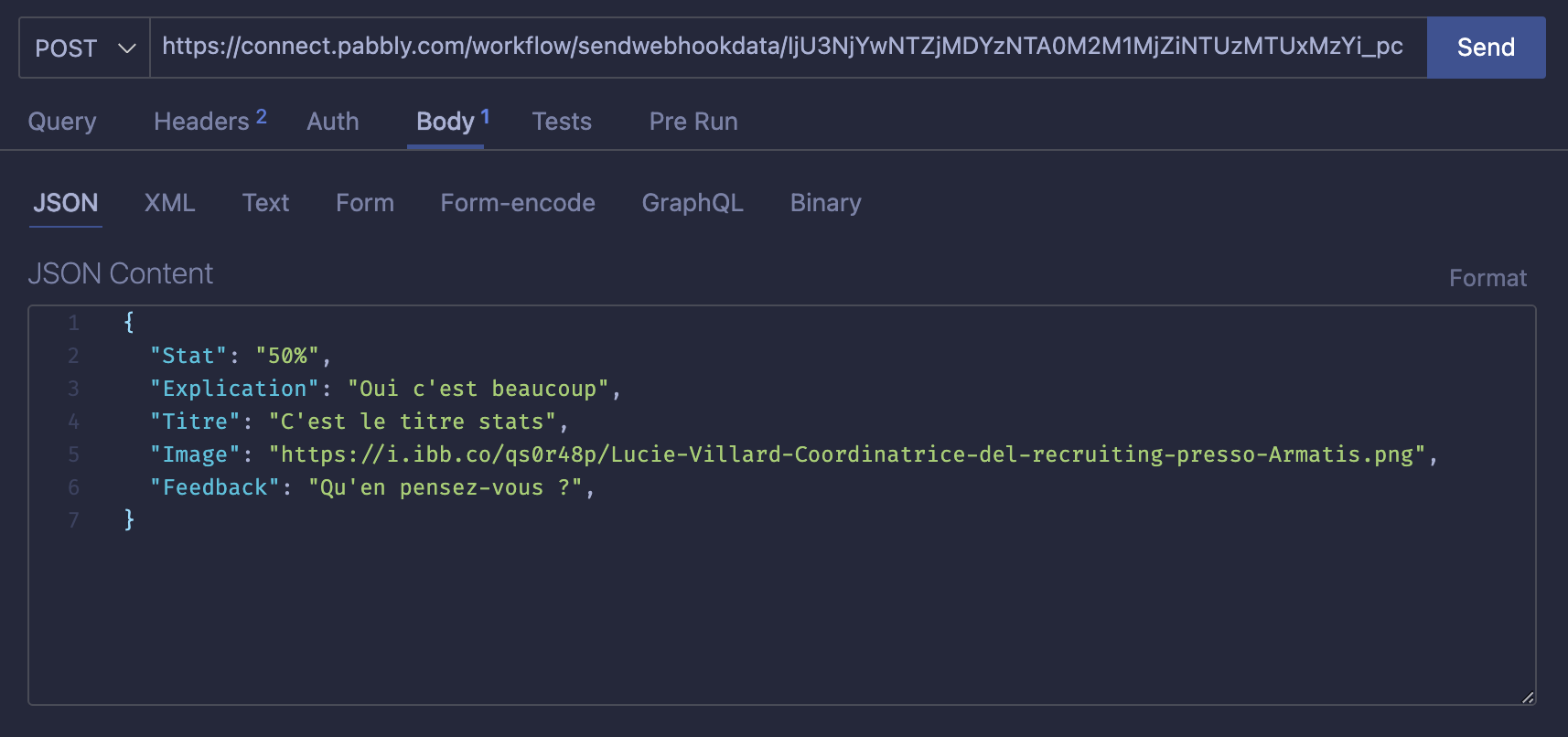

Here problem appear when I'm calling Pabbly workflow from Make.com with HTTP request
Hi @ArshilAhmadThis one and others for Webhooks problem (first step) :

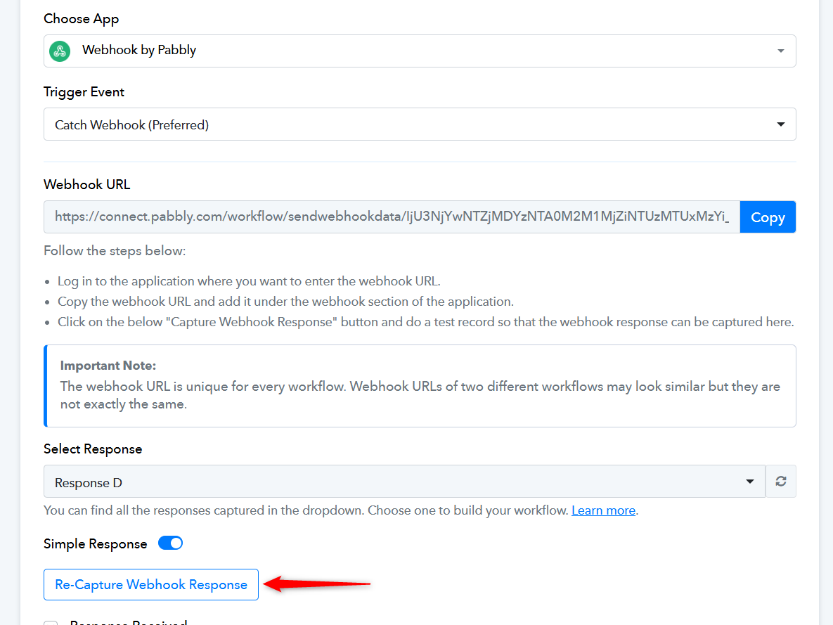

Please click on 'Re-Capture Webhook Response', capture a new response, and check if it provides the response in different fields

Please add a Delay of 5 minutes between step 2 (Upload Asset) and step 3 (Get Asset Upload Job) of your workflow and see if that fixes your issue.

Recapture :
As I mention, Re-Capture do not split properties since 2-3 days
Workflow : https://connect.pabbly.com/workflow/mapping/IjU3NjYwNTZjMDYzNTA0M2M1MjZiNTUzMTUxMzYi_pc
And for the delay :
The delay does not help resolve the issue, as we don’t receive the MediaId through the Pabbly module.
The problem is that your module returns a success response, even though it only provides an “in-progress” status. This needs to be fixed.
Adding a delay doesn’t work when triggering the Pabbly Webhook (Workflow) via an HTTP request (with Make.com); the request ends prematurely with an incomplete response. As a result, there’s no Dataforwarder response from the final module step in the Pabbly workflow.

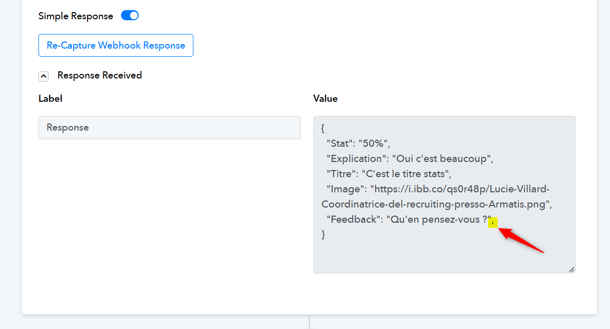

There is a trailing comma after the last key-value pair. Please remove the comma and re-capture the response.

Thanks you, that work for the coma
