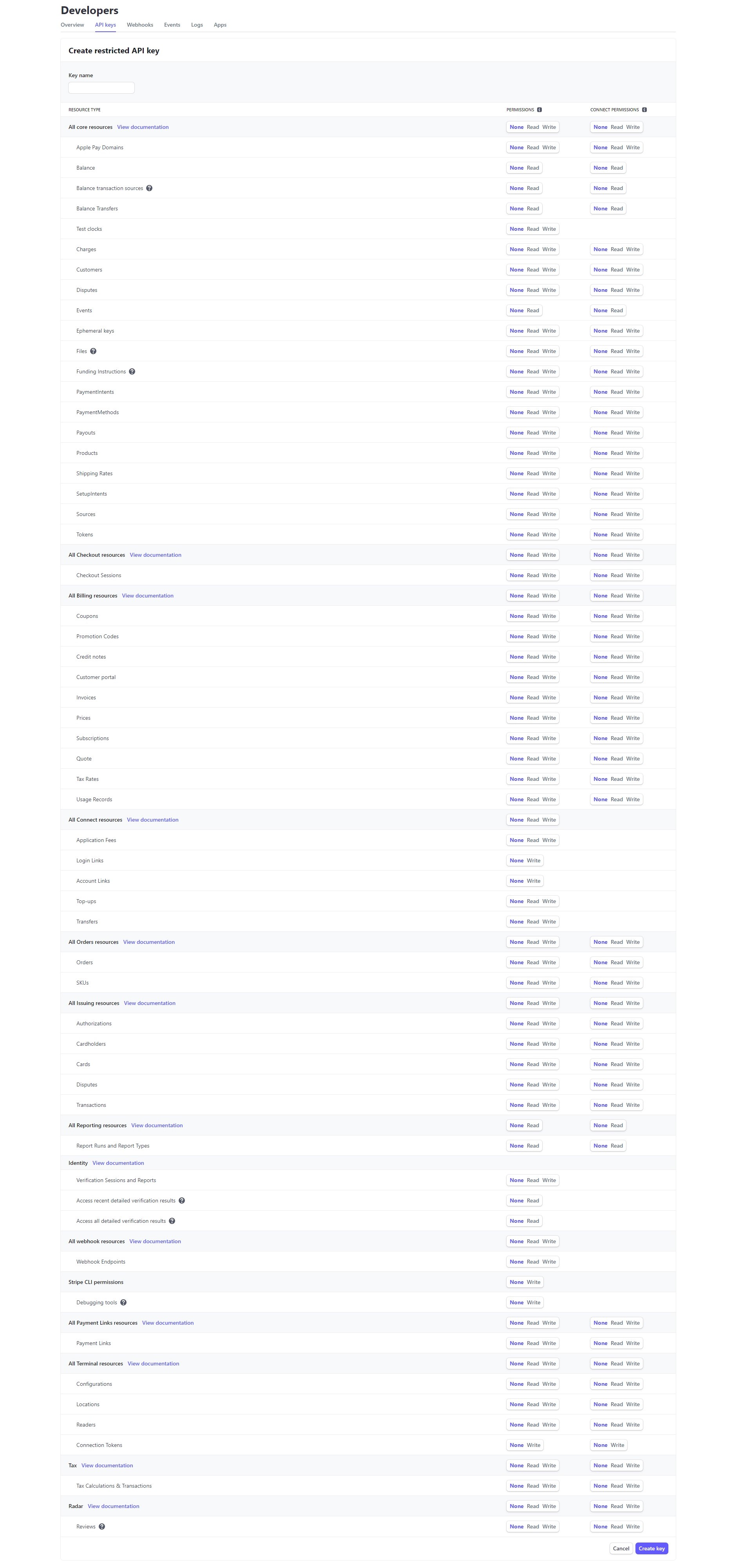

Hey!
I emailed you this question and you sent me a video explaining how the basic integration works using my - I already have my main API key setup for the integration but I'd like to switch it to a restricted key but I need to know which resources in Stripe Pabbly subscriptions needs access to. And whether you need read or write permissions.
I attached a screenshot of the full list. Most apps only need checkout and webhooks but I wanted to double-check.

Hello Lena,
Please allow us one more day to confirm this with the dev team. I'll let you know the detail once I get the solution from them.

Hello Lena,
You can tick the selected events from the screenshot for generating the keys and please mark the checkboxes with the appropriate options: Read & Write. However, if you see Read only or Write only, please mark Read in the Read only section and mark Write in the Write only section. Please check the screenshot here - https://www.screenpresso.com/=gvjYd
