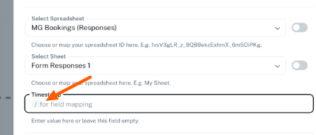

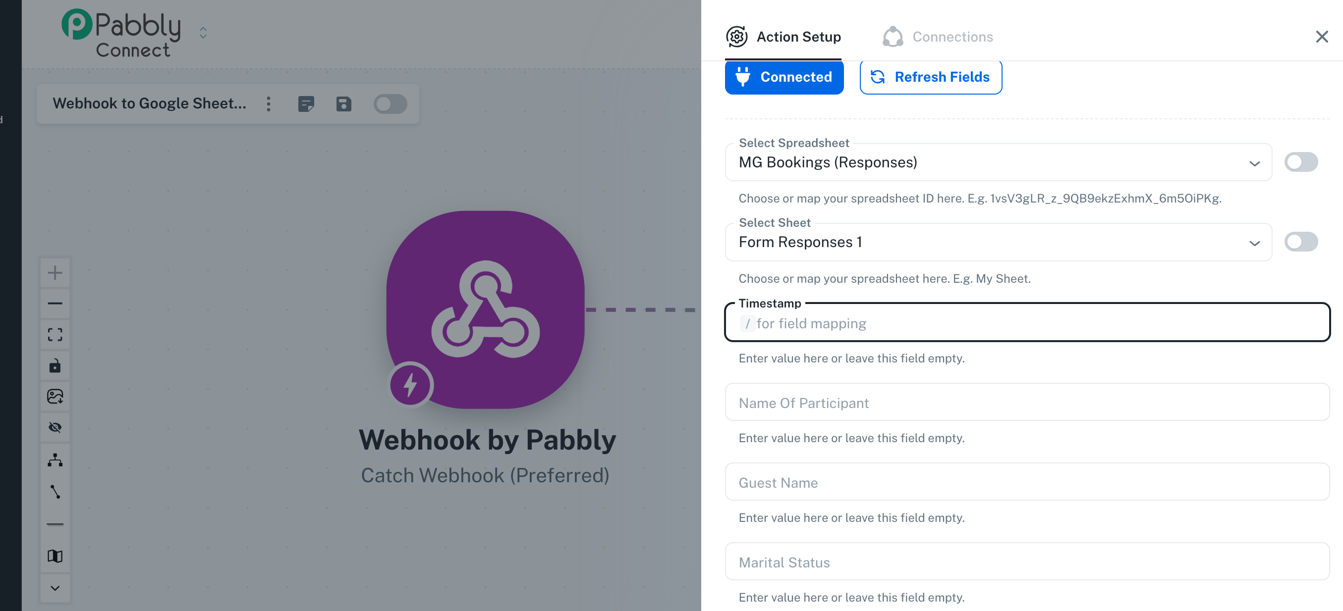

Hello! as title states, I tested the webhook and the data looks correct, however on my next step, I connected to google sheets, but cannot map the data! Any help please? No drop down to map.
Andres360 — Reply ·
I cannot see the toggle mapping
Hey @Andres360,
Thanks for reaching out.
As mentioned in the placeholder for that field, you need to enter a forward slash “/” in the mapping field to fetch and map the data correctly.
Please try adding / and you should be able to proceed with the mapping. Let us know if you face any issues further.
