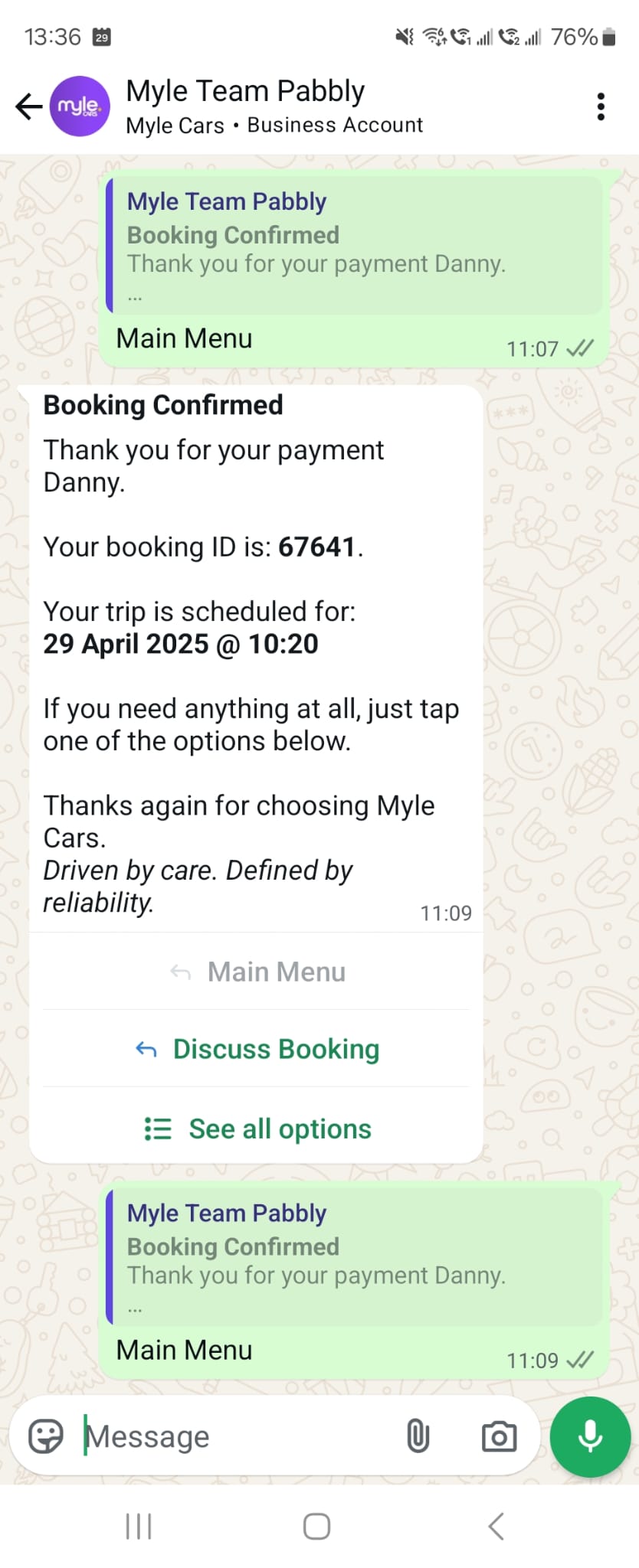

Hi there,
I am using an automation to confirm payment using pabbly connect which then uses the whatsapp api to try and keep the flow consistent for the customer. So after payment is confirmed it seems to them its all part of the same chat.
I have gotten it to work but then it leaves the customer stuck with no follow up messages from the chatflow.
So I decided to use quick replies and then program in keywords to direct the customer after a sale.
However, they aren't working.
One of the quick replies is "Main Menu". When clicked it does nothing but when you manually reply to the message "Main Menu" it works.
Is there a way to get this to work?
I have tried the 5 options and none of them work but they work when I manually type the message out.

Its the chatflow not registering the template message quick replies that is the issue not the connect workflow but I will send over what I have been working on.
https://connect.pabbly.com/workflow/mapping/IjU3NjYwNTY4MDYzMjA0MzY1MjZmNTUzNzUxM2Ii_pc
When I click "Main Menu" quick reply I hoped the chatflow would trigger the "Welcome" chatflow but it doesn't do anything.
When I type "Main Menu" it will work.

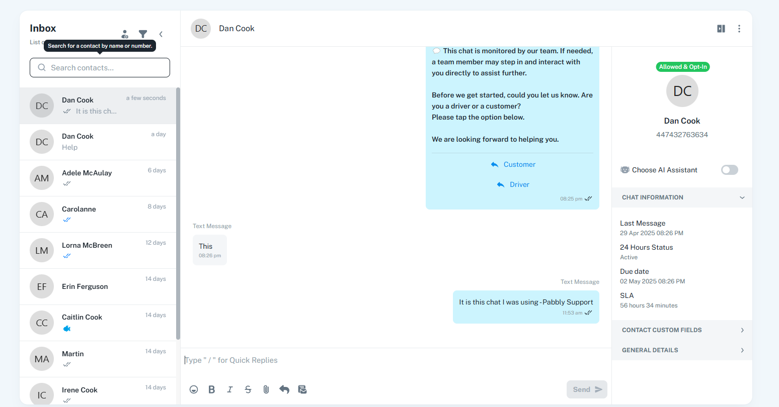

Thank you for the information. Could you please let us know in which inbox chat you tested the welcome flow? Additionally, kindly share the name of the template that was sent, as shown in the attached image. This will help us investigate the issue more effectively.
We look forward to your response.
Dan Cook — Reply ·
I was using booking_paid6 template.
I used a chat with myself and I marked the chat for you with a message.

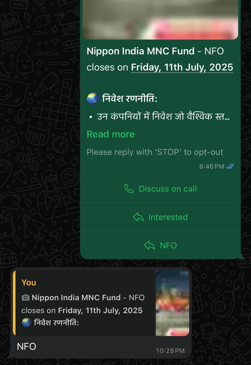

Same issue is coming with me. my quick reply buttons are not taken as keywords in flows.

Receiver clicked on NFO button, but no flow attached with NFO keyword is activated.

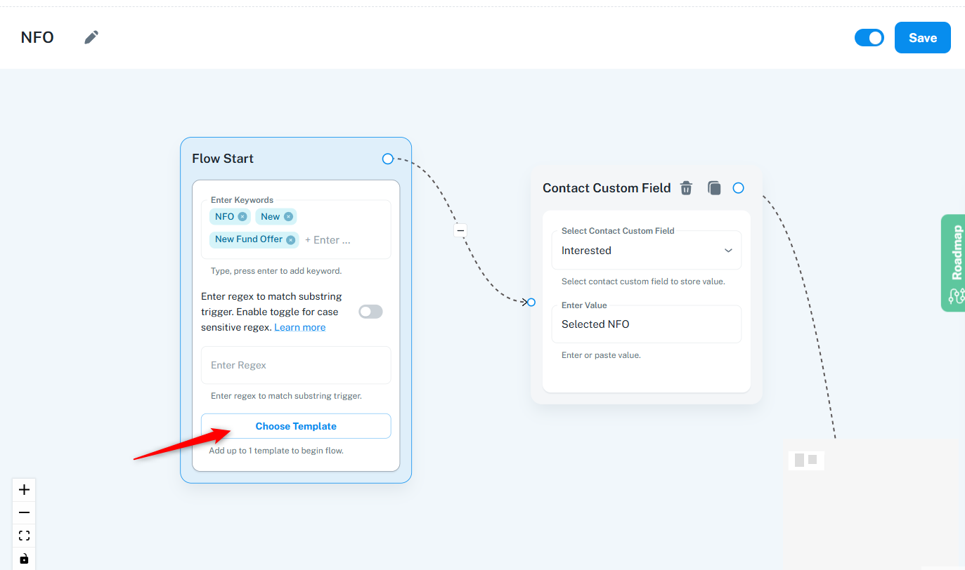

Please add the relevant template to your 'NFO' flow and see if that fixes your issue. Make sure to connect it to the rest of your flow.
