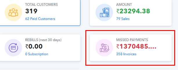

I have automated a course selling process and I am noticing that a lot of payments are missing and only a few registrants are getting enrollment mails as per the automation set.
Why is it not smooth and how to fix it?

We would like to inform you that we have checked your account and we found that you are getting more Missed Payments since your customer does the checkout but did not complete the payment process so the customer created as well as invoice also generated and Subscription shows in Pending State and Invoice shows created and under sales tab it shows overdue. So, once your customer pay for that particular Invoice then the payment will not show in missed payments and it will come under Amount.
Please check the same at your end too and still you face any issue then please feel free to reach us.
