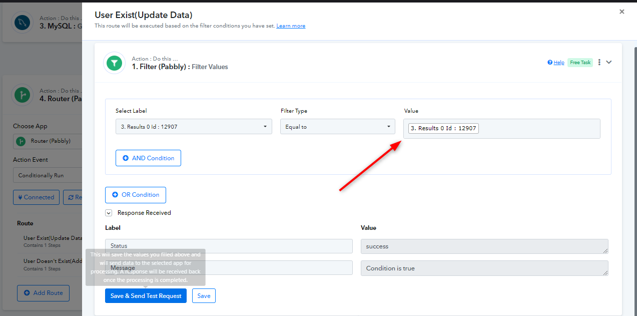

Hello Support,
I have setup a workflow where I am check the entered email is present in our database or not. If it is present then I am taking the user to User Exist router and if not then taking the user to Not Exist router but here from yesterday it is not working as expected always it is going to User Exist router and executing all the flow except update mySql update rows and sending email with blank data.

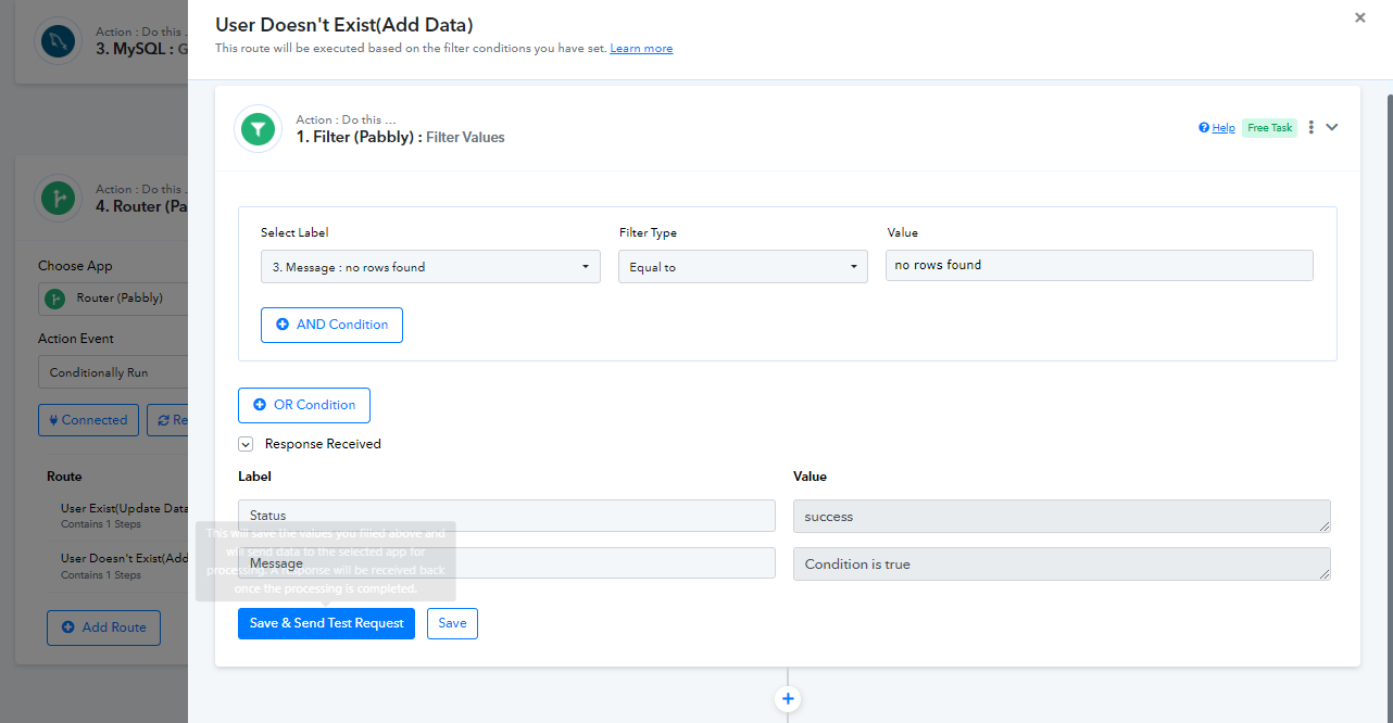

Hey @ankitbatra94
We have made a few modifications in your first Filters which differentiate between the email which exists in SQL or not. Kindly try it out and let us know if your would need further modifications in other filters.

Hey @ankitbatra94
We have set up the Filters according to your use case. Kindly refer to the images below,
