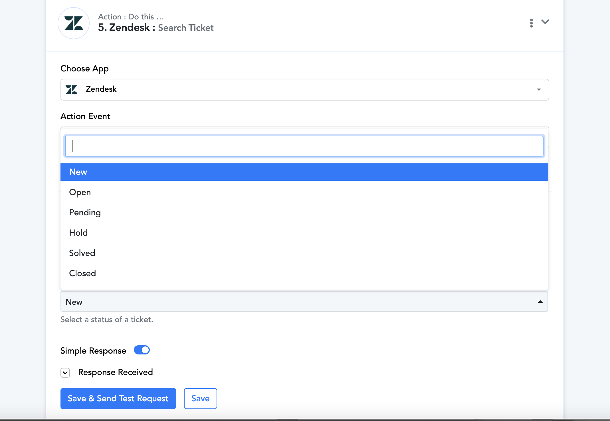

Hi - I am attempting to build a workflow to take webhooks and categorize them into tickets in Zendesk. I need Pabbly to search all open tickets within Zendesk to see if there is already a ticket open with that unique ID. Everything I read is telling me that I should be able to enable the search feature and have it search all tickets that are not solved ("status
Is there a way to have it search all open tickets?

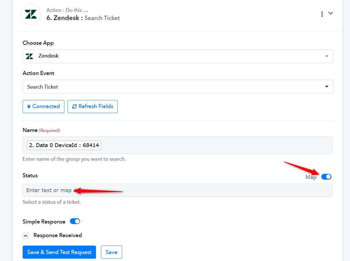

You can enable mapping and remove the status entirely. This will help you search for tickets of all statuses. You can then add a filter to the workflow to ensure that the next steps are not executed if the ticket status is set to 'Solved'.
Hey Arshil -
I did what you suggested but when I removed the status, it returned no results when a test run was done. When I refresh and add the "open status" back into the mix, it does find the ticket.
Could you please enable your workflow and make a test submission? Kindly avoid making any changes to the workflow before the test submission.
Done. Two went through.
It seems you made a submission using a Ticket ID that didn't exist in your Zendesk account. Please make the submission using a Ticket ID that already exists in your Zendesk account. Now that '68400' has been created, you can use this ID for the test submission.
