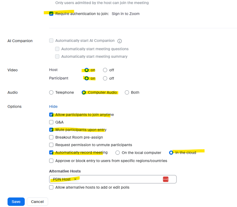

Hi all, I've got a custom API element creating a Zoom meeting and whilst it successfully creates the meeting event in Zoom, it forces the settings to be 'Registration - Required'.
I've tried many different settings to stop this and have also checked the back end Zoom settings from the Admin log-in, but it's still not working.
Here is my current code -
"topic": "1. NAME : Test Event",
"type": 2,
"start_time": "2. Result : 2025-05-01T14:00:00+10:00",
"duration": 180,
"timezone": "Australia/Brisbane",
"settings": {
"host_video": true,
"participant_video": true,
"join_before_host": true,
"mute_upon_entry": true,
"waiting_room": false,
"approval_type": 0,
"meeting_authentication": true,
"auto_recording": "cloud",
"audio": "voip",
"alternative_hosts": "[email hidden]",
"in_meeting": false,
"close_registration": true,
"registrants_email_notification": false,
"registrants_confirmation_email": false,
"registration_type": null,
"use_pmi": false,
"enforce_login": false,
"authentication_option": "",
"approved_or_denied_countries_or_regions": {
"enable": false
The end point I am using is - https://api.zoom.us/v2/users/me/meetings
Is there anyone that wouldn't mind taking a look to see if I'm missing something?

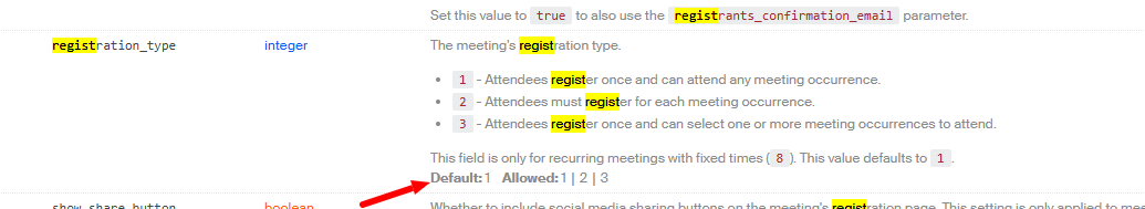

Hello @projects@developernetwork,
Upon reviewing the API documentation, we noticed that the registration type can be set to three values: 1, 2, or 3, with the default being 1. Currently, in the action, you are passing null, which results in the default value being applied in real time (1), meaning attendees register once and attend recurring occurrences.
However, as per the API documentation, there doesn’t seem to be an option to disable registration.
Let us know if you need further assistance.
